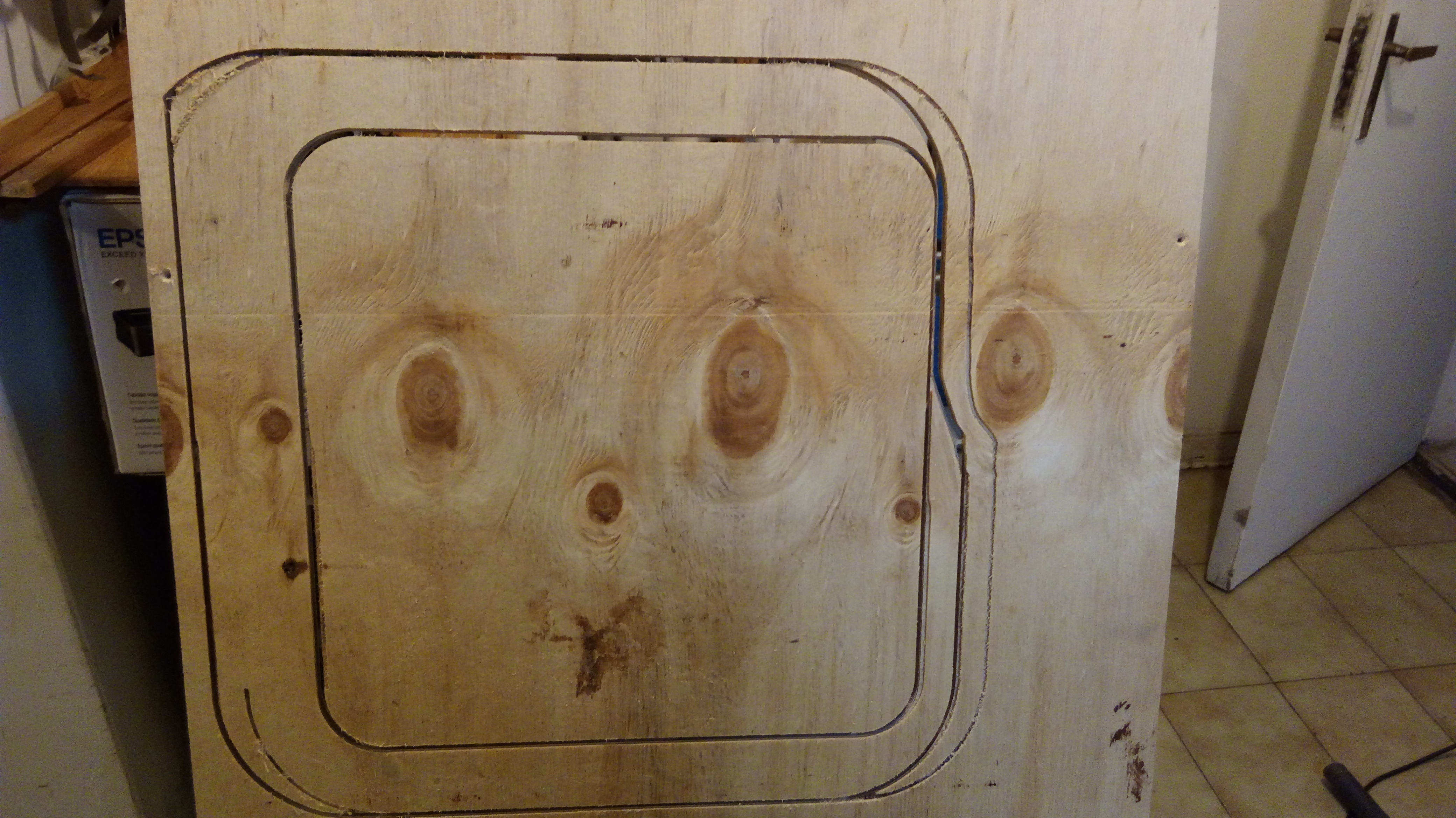

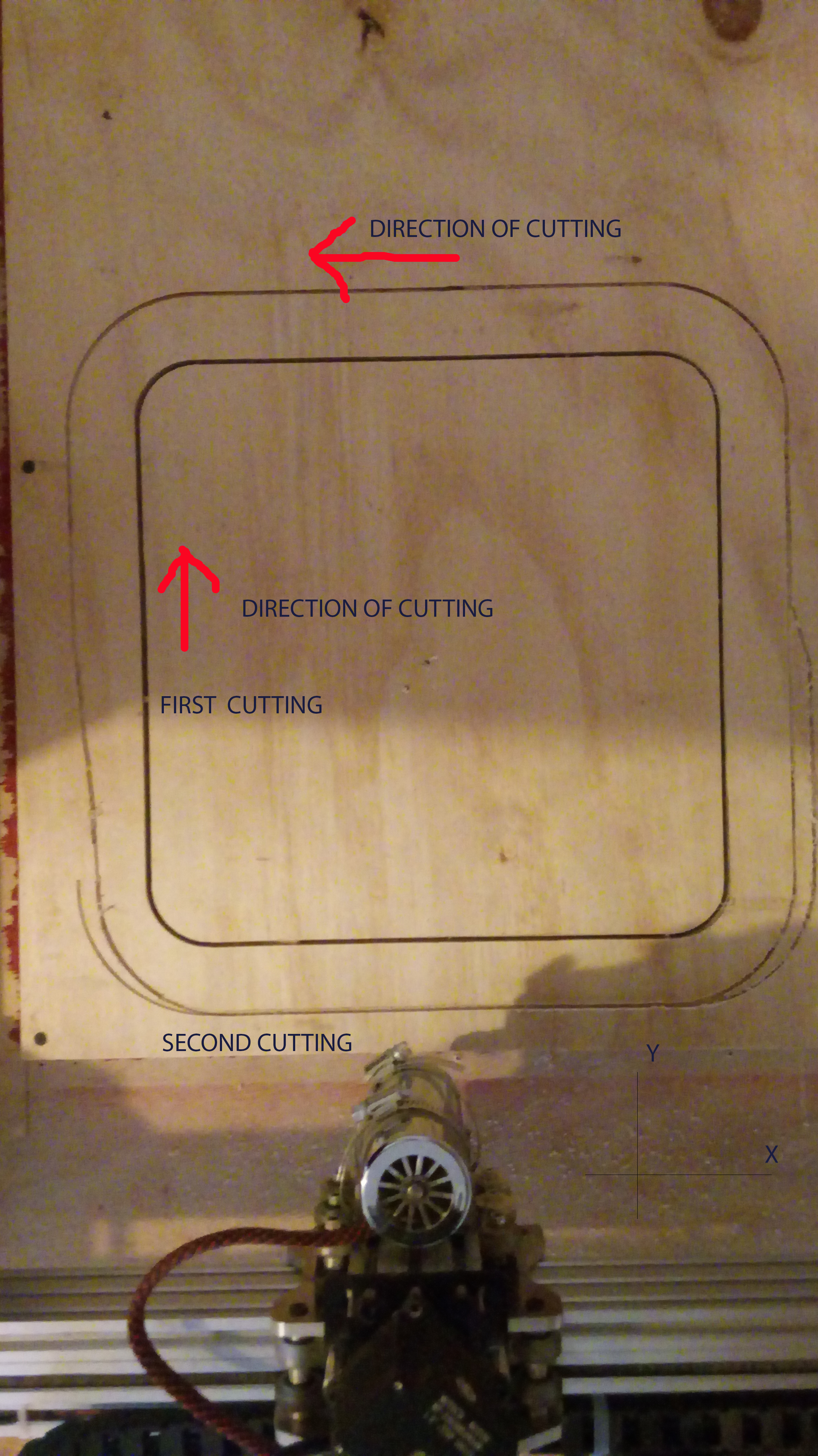

Hello friends, i just to want to ask for your help, i have a permanent problem with my ox machine, when I try to cut some design, the machine for a reason that escape my knowledge start to loose it´s course and loose it´s straightness, the interesting part of this, it´s in the same gcode file the machine cut perfectly the first part, but the second, start to loose it´s way. The funny thing, is that this problem exist since the beginning, I thought It might be a problem with the board, so I bought another, because I double check that nothing is loose in the mechanical part, I check the belt was tight enough, and check the squareness of the frame, everything seems ok. The first cut was perform cw and the second ccw. The feedrate was 800mm/min, the depth of cut was 1 mm, the spindle rpm was 10000. The material was plywood. i used a 2 flute end mill ,I really appreciate your experience and advice about this problem.

@Felipe_de_la_jara Since the wrong movement is in the x-direction, it is most likely being cause by one of the y motors not moving in sync with the motor on the opposite side. Notice how straight your cut is when the y-motors are not moving? A y-motor inconsistency will cause one side to move further than the other until missed steps occur causing an effect of “walking” the entire gantry. Think of only one side moving up until there is so much tension that the other side finally releases and gets dragged along. That would definitely cause a skewed cut.
Based on my very recent troubleshooting, I would loosen the belts over both y motors, send a command and visually watch them to make sure they both react together. It will be obvious if they don’t.

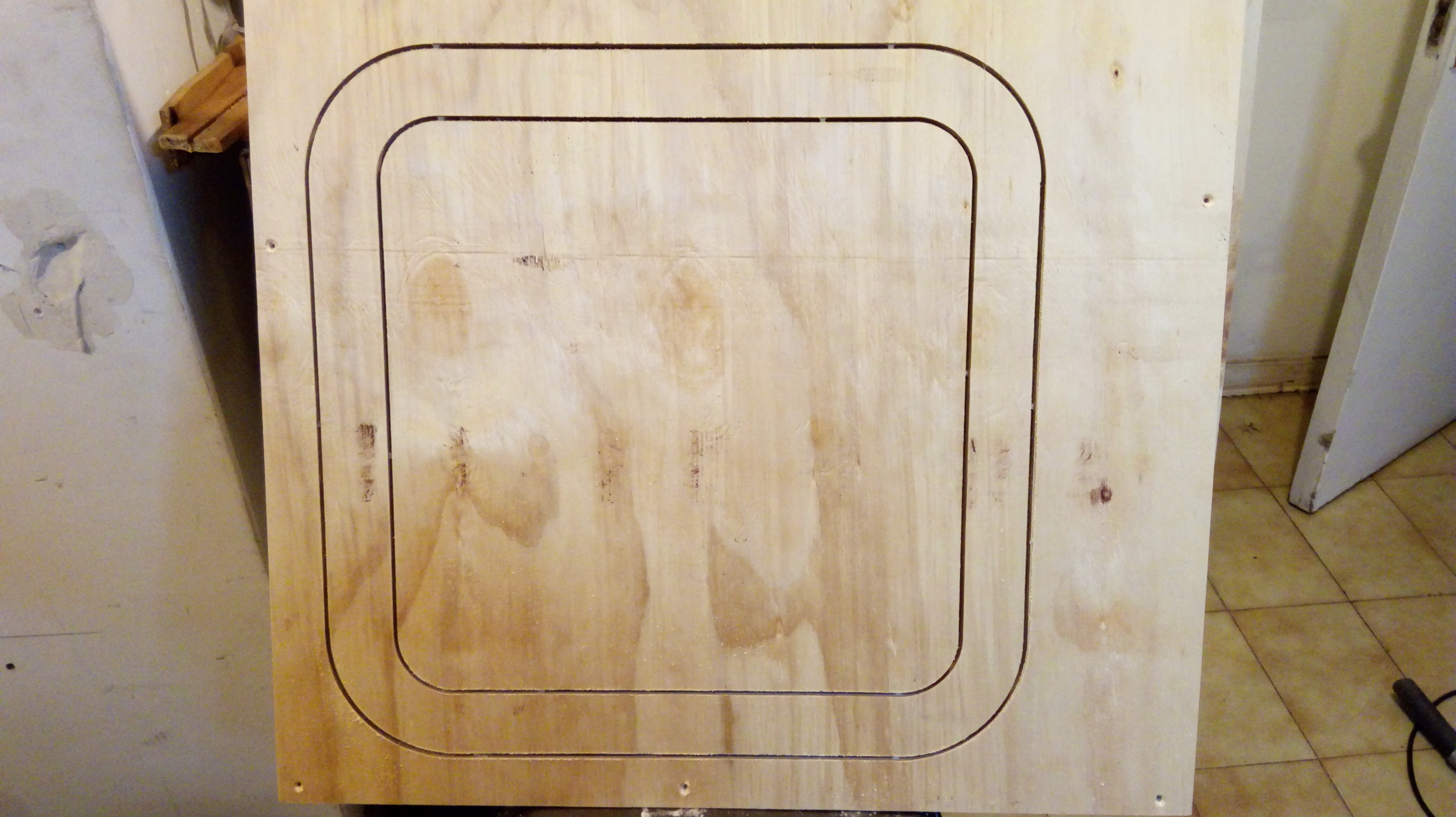

hello friends, i´ve spent this weekend trying to solve the problem that im still having with my machine, as just you recommended guys, first i loose the belt a little and this is what happening, the first cut was ok, but the second the machine wnet mad. the second thing that i did, was to remove the y and x belts, just to check the timming pulley, to my surprise, iv found that one of the y pulleys was loose, and the x pulley was complete loose, so i´ve tighten it both, i put back the belts and the next was…

finally¡¡¡¡¡¡¡¡¡¡¡¡¡ a perfect job with no problems at all, the machine just works perfectly and i was really very happy, until i remove the plywood to put another and start to make the same job, i reset the machine, and reload the file in chilipeppr, for my dissapointment, the machine start to make the same mistakes that did it before, this time in the first cut. as michael forte suggest, before to reassemble the belts i run the work to check if the motors are running, and yes, the motors were working just fine.
