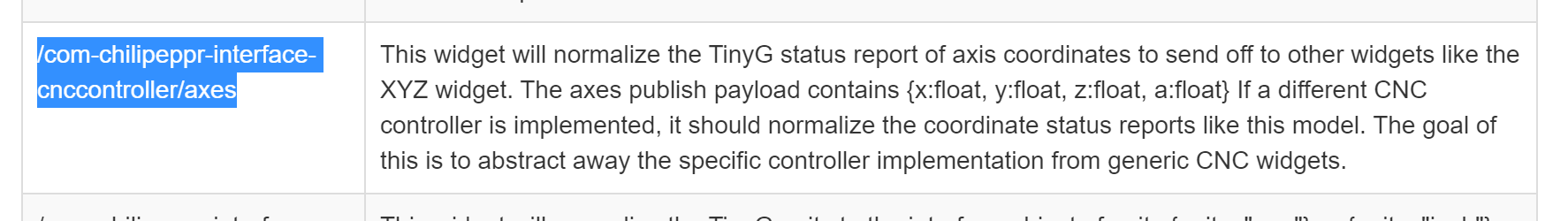

For the XYZ location, did you try just subscribing to this pubsub?
It’s in the pubsub for the TinyG widget

I hope to have some code to show today that does display the position. Modified one of the routines that compaired the position to 0,0 and instead had it output the contents of the x and y position. Now going to include this in the onExecute and Pause routine.
This is where I’m at now. I can read the position two ways.
onRecvPosition: function(pos) {
// we get a nice object of XYZ values
if ( pos.x != null | pos.y != null )
macro.status("Position X = " + (pos.x != null ? pos.x : 0)+ " , Y = " + (pos.y != null ? pos.y : 0));
This function gets multiple values and the first and last values are null which I suppress.

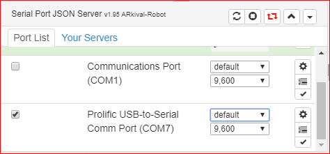

Now trying to understand how to receive data on the serial port other than the default.
In the Widget / Serial Port JSON Server I have selected a non default serial port.
I just want 9600 Bits Per Second, 8 Data Bits, 1 Stop Bit, No Parity, No Flow Control.
I selected default and 9600 in the widget. Is the correct choice for my setup?
NonDefaultPortSPJS
I chose the “Send Serial to CNC and Arduino Simultaneously” Macro.
What I want to do is just capture the serial port output to the log but I must be missing something.
My device is sending continuous strings to the serial port and I have subscribed to ALL serial ports.

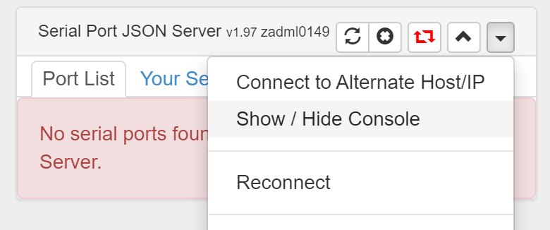

Just print the data as it comes in, so like the first line of your onRecvData method, just so you can debug better. I don’t see any other issues.
If you want to know how SPJS is formatted, just show the console for the SPJS widget.
Showing that console will also let you see what you should be getting in your macro.
SPJS

I thought your Prolific device was on COM7? Not COM1
It was originally but I had to return the borrowed usb to serial adapter so I’m now on the COM1.
Must be something wrong with COM1 on PC. I got COM7 working on the SPJS Console
Making progress now using COM7, something was wrong with my hardware COM1
