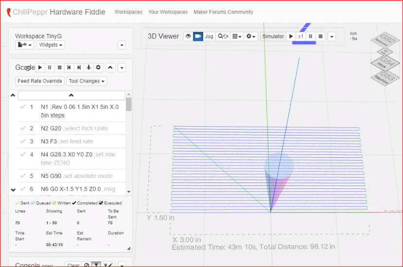

Can you post a screenshot of the toolpath in the ChiliPeppr screen so I can get an idea of what it looks like? And possibly also post some of the Gcode? I want to see if there’s a way for you to add an M6 tool change pause at each location you want to collect data from. Perhaps the M6 is best trick because the Gcode widget will play to that part, send out a pause, then you can record your data, then unpause the Gcode.

This is the G-code for the screen shot I posted previously
;Rev 0.06 1.5inX1.5inX.05in steps
G20 ;select Inch Units
F3 ;set feed rate
G91 ;set relative mode
G28.3 X0 Y0 Z0 ;set machine ZERO
G0 X-1.5 Y1.5 Z0.0 ;msg X Forward Direction start at -1.5,1.5,0
g1 X3 f3 ; Go +3 inches X Axis
g0 y.05 ; Go +.05 inches Y Axis
g1 X-3 f3 ; Go -3 inches X Axis reverse direction

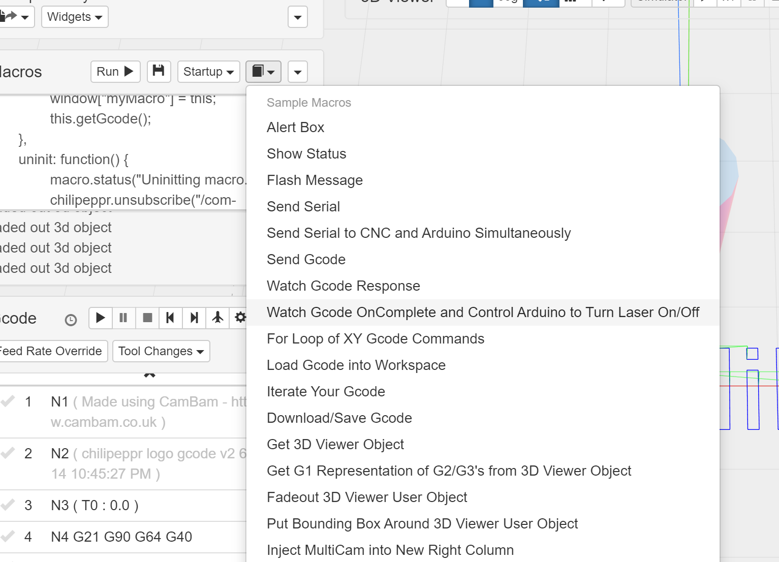

A did you look at the sample macro for the on complete event
Yes I did, my problems now are with setting up a development environment. I even made some changes to the macro to parse the G-code G4 P1 to display the line number when it found the pattern, I’ll watch the videos again to see how to clone the project and make the changes. I’m new to this environment but will be ok once I figure it out.

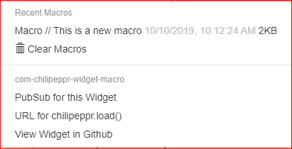

You don’t need a dev environment. You just edit the macro.
So, turn on macros.
Load this macro.
And edit it to your heart’s content right in that edit box.

Thanks, I loaded the macro that dispenses the solder paste as that one uses onChiliPepprPauseOnExecute which is supported on my TinyG.

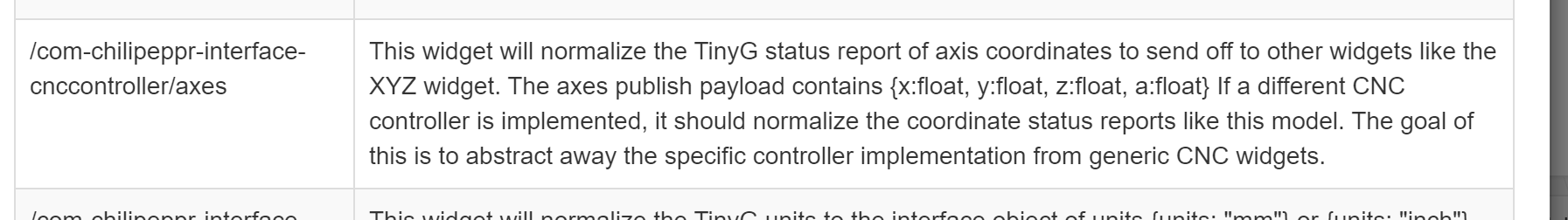

I think this would be a reliable way to get the robot position data to put with the measurement data.
Can anyone suggest another way to get the current position X,Y,Z for the robot?

You get data passed back to you in the callback that I believe has the line of gcode. My recommendation is print that data to the console while you are debugging and it will help you immensely.
In looking at the code for that sample macro again, it really does have everything you need in it. It shows that on the callback you can look at the line of Gcode and see what’s in it. So you could get the position from that. However, you can also subscribe to the axes published signal from the TinyG widget pubsub.

When I make changes to a Macro and Save the Macro I can see it on the dropdown menu.
Is there any way I can make a file from it so I can use another editor and print it for reference?
There are times when I’m away from the Internet and want to work on my macro programs.
How Persistent is this macro? Can I load it from another instance of Chilipeppr on a different computer?
Thanks
Recent%20Macros
Yeah, you just have to cut and paste it into a text editor. The browser is a sandbox and makes it hard to do local files natively, so you just have to use your clipboard.
Thats what I’m doing. Got the Pause and unPause working now trying to display the XYZ location.
After that I’m working on the serial port send and receive. Thanks for your help
