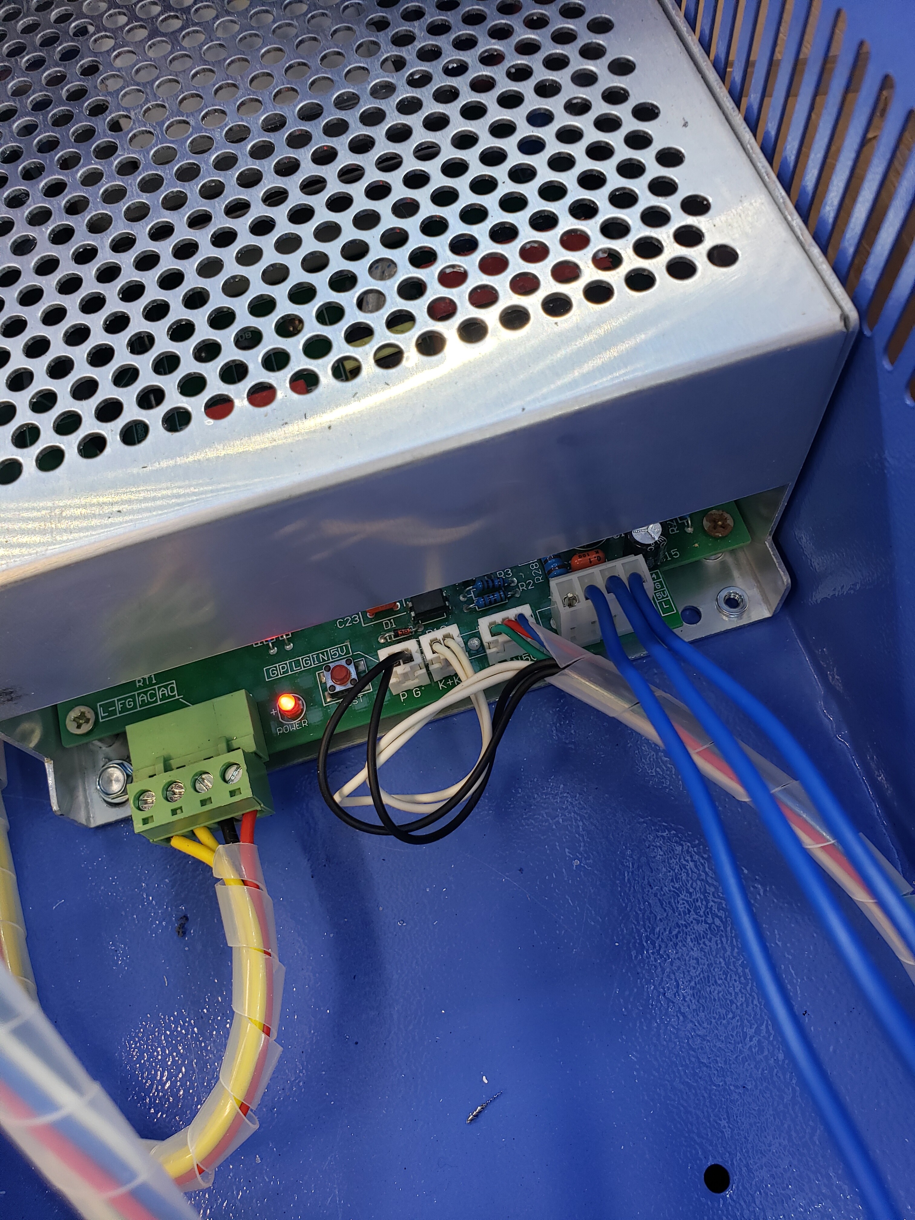

Hi Don, here is a picture of my PSU.
My c3d board is connected using the three blue wires (G, 5v and L).
The two black wires go to my test button on the control panel. That test button works. When I put a jumper between the G and L pins on the PSU (blue wires), nothing happens.
I tried on my Machine #1 using the same jumper, and it triggers a fire. I checked my blue wires carefully with ohmmeter for conductivity and it’s all good.

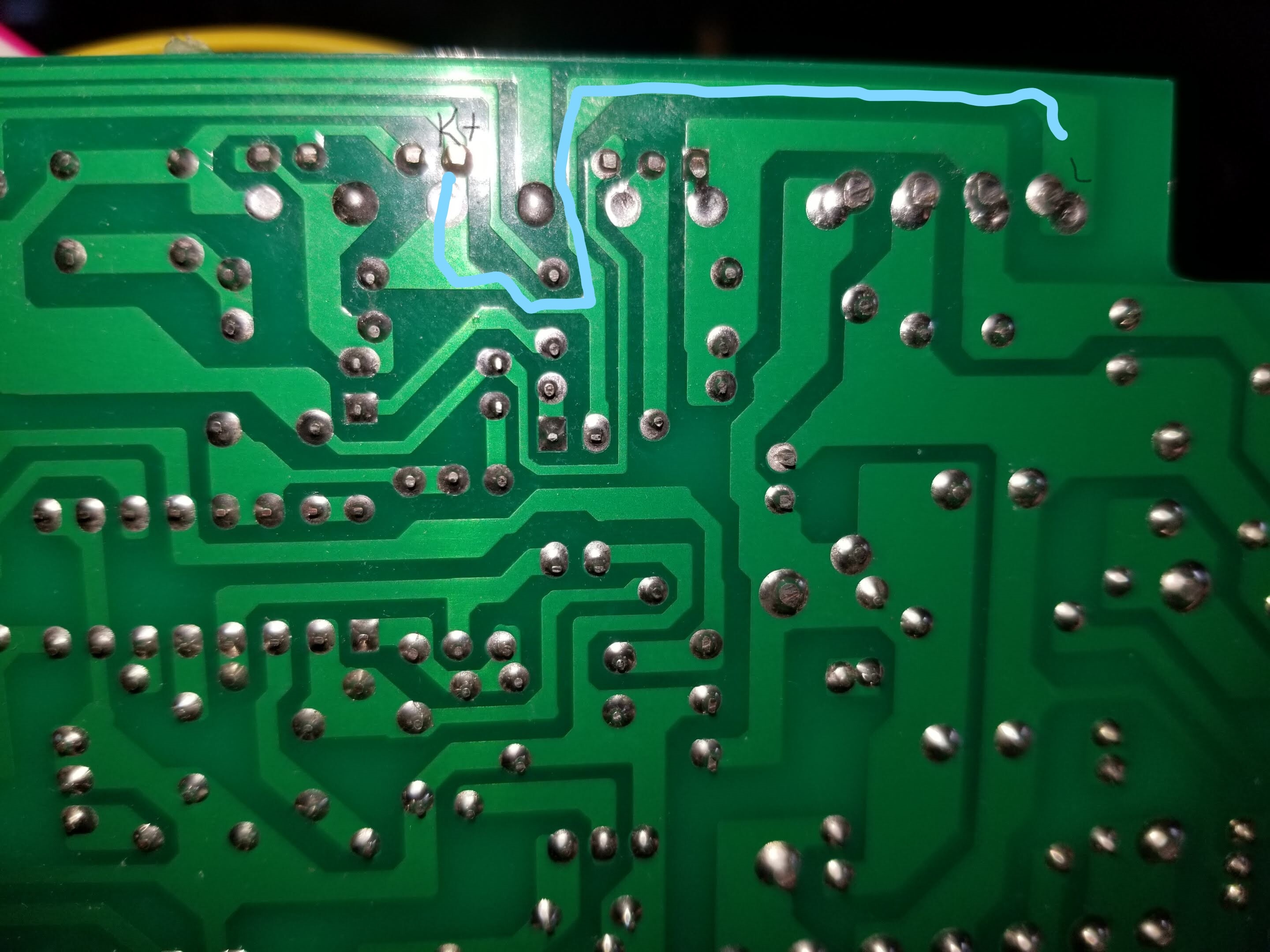

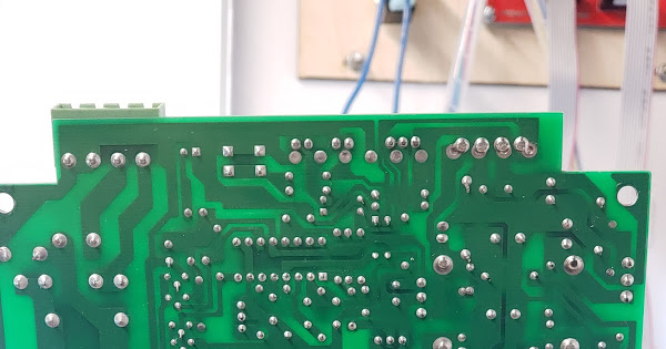

Find out why L is not connected to K+. Look for poor solder joints etc.
It looks like my PSU is different from what you are showing. For me, L has continuity with K-, not with K+ (I’m at 0.8 ohms, in both direction).
My K+ is connected to the ground and offers very little resistance (again around 0.8 ohms).
I can’t see anything that looks unsoldered, or burnt or whatever strange…
