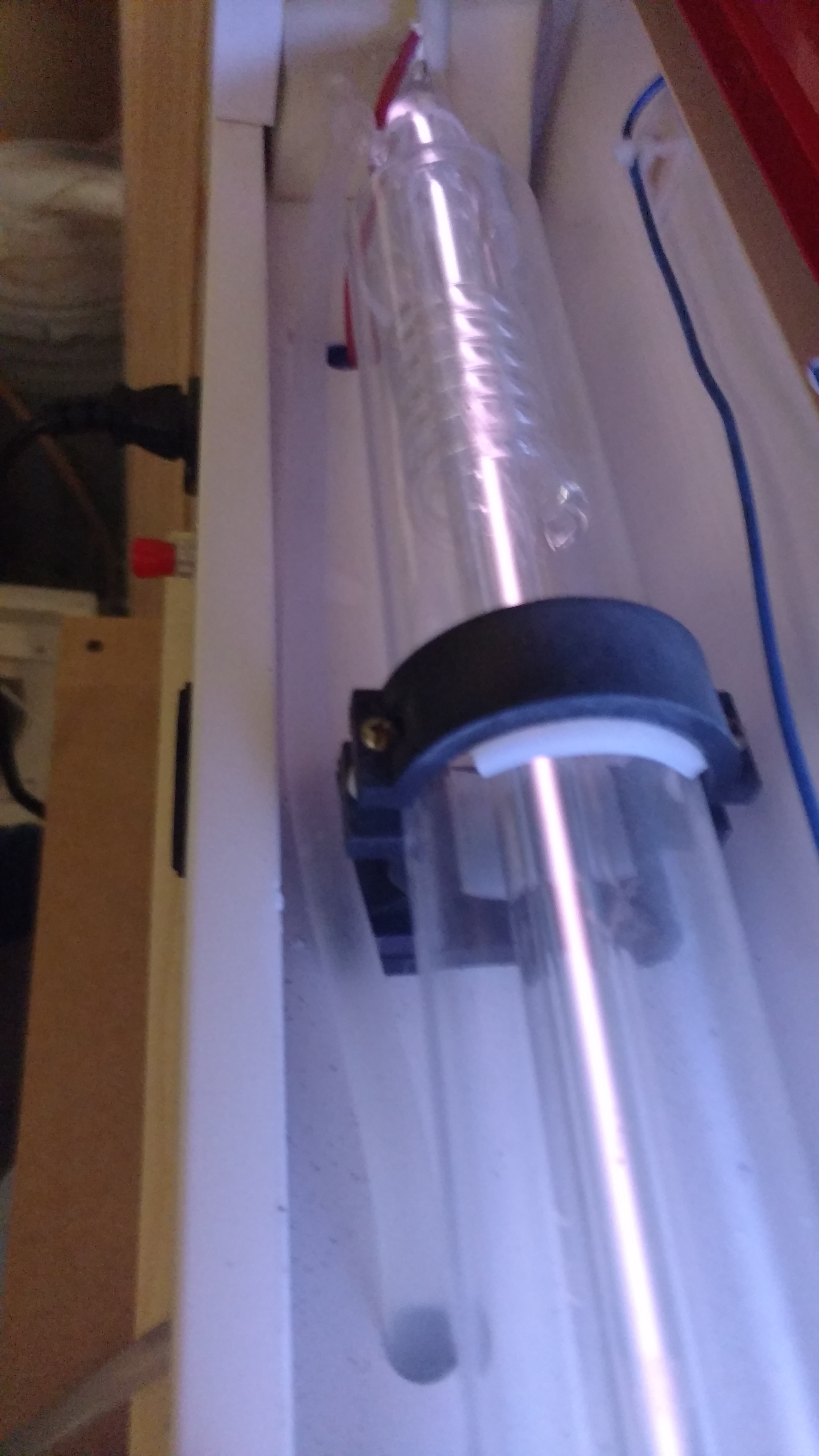

So I have been using the K40 for a month now testing and playing… Tonight I finished a new bed for the system and started to run a dxf vector cut to make a new rotary. It ran through once but not all the way through the mdf. 1/4 way through the 2nd time the power just cut out of the laser. All electronics appear to work fine. When I put the setting to less than 10% you can hear the test fire and a glimmer or light through the tube. if i put the settings above 10% the tube lights up solid and there seems to be no output. attached is a picture when it just lights with no real output.
Check your mirrors and Alignment. Looks like the laser is firing but not getting to the work

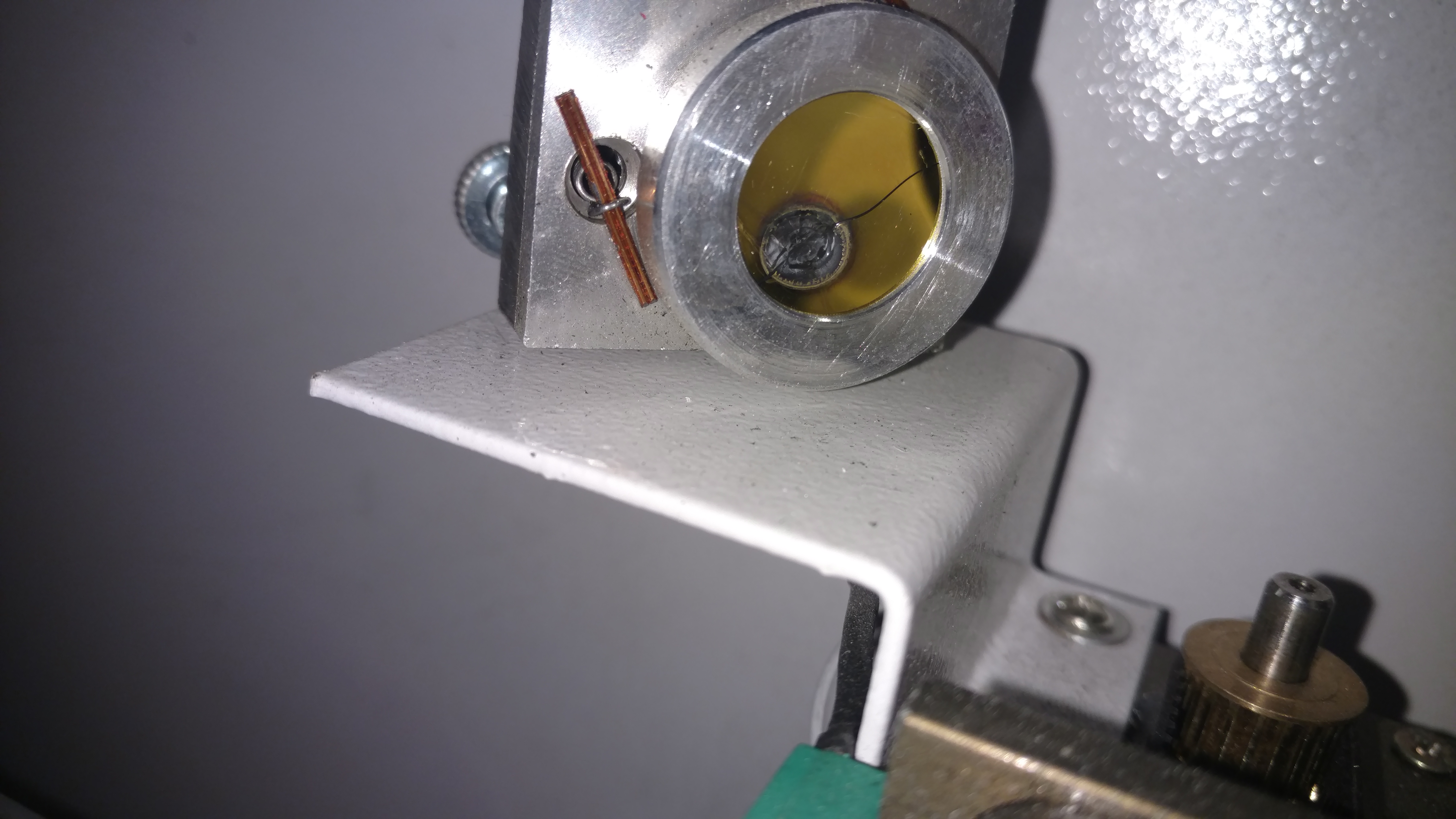

ok well that may definitely be part of the problem. looks like somehow ( i have no idea how) it burned through the one attached to the Y carriage. Does anyone know of a good place to get mirrors that wont break the bank?

I have to say THANK YOU!!! to all for the quick response and ideas… pulled the mirror which disintegrated in my hand. I was worried about the tube but i think it is ok. although i did notice a water bubble so i need to address that, have a couple people waiting on me so i have to rush order the mirrors. 3 mirrors from amazon being delivered overnight for free shipping(One of the times Prime pays for itself). fingers crossed i will be back and running by sunday night.
The stock mirrors on most chinese lasers are garbage, my 60W burned through both stock mirrors in less than 5 hours of run time. Replaced them with some good quality MO mirrors.
