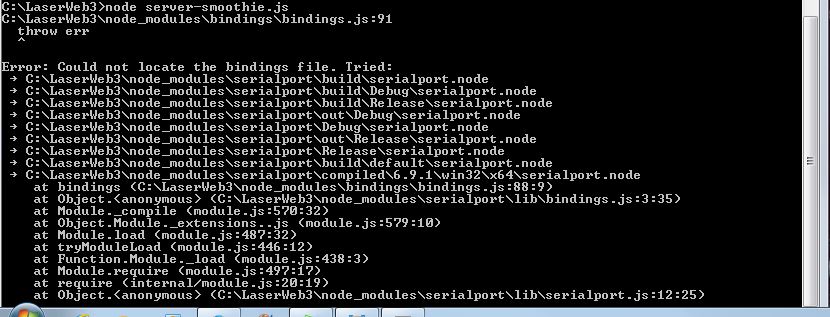

Help! So I upgraded to the C3D Mini board and am trying to install laser web and I get… I am on the github wiki and following the instructions to a T. I am running Windows 7 X64 if someone could give me a hand getting this going, that would be amazing.

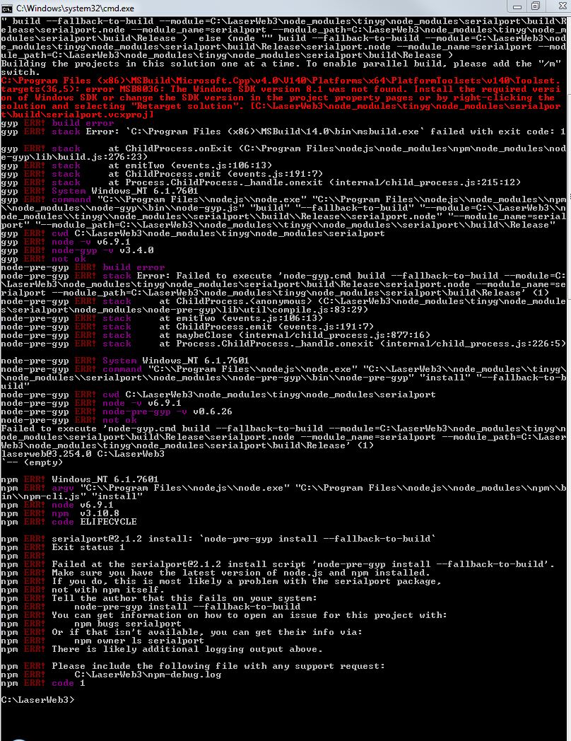

+Peter van der Walt Installing python for windows as I write this, Previously installed the latest Microsoft SDK, and I did have a Visual Studio on here for some other reason so that is all up to date. After the python is installed will attempt it again.
Edit also doing the install from your link.
+Peter van der Walt At Any rate I could get mad enough and wipe this install haha… if so… recommended a version of windows to use?
+Peter van der Walt Welp… Same errors. I will likely go ahead and upgrade my windows… Eeek, took me so long to leave XP and even longer to think about ditching windows 7 lol… I don’t like change too much. Oh well been meaning to swap in a few SSD’s anyway. Thank you kindly for the response and I will likely take a new swing and mighty leap tomorrow.

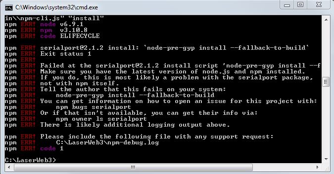

I had this problem too. type “npm install serial”

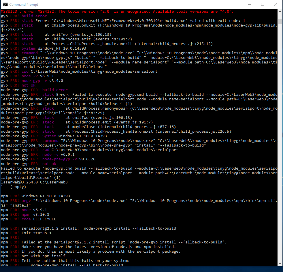

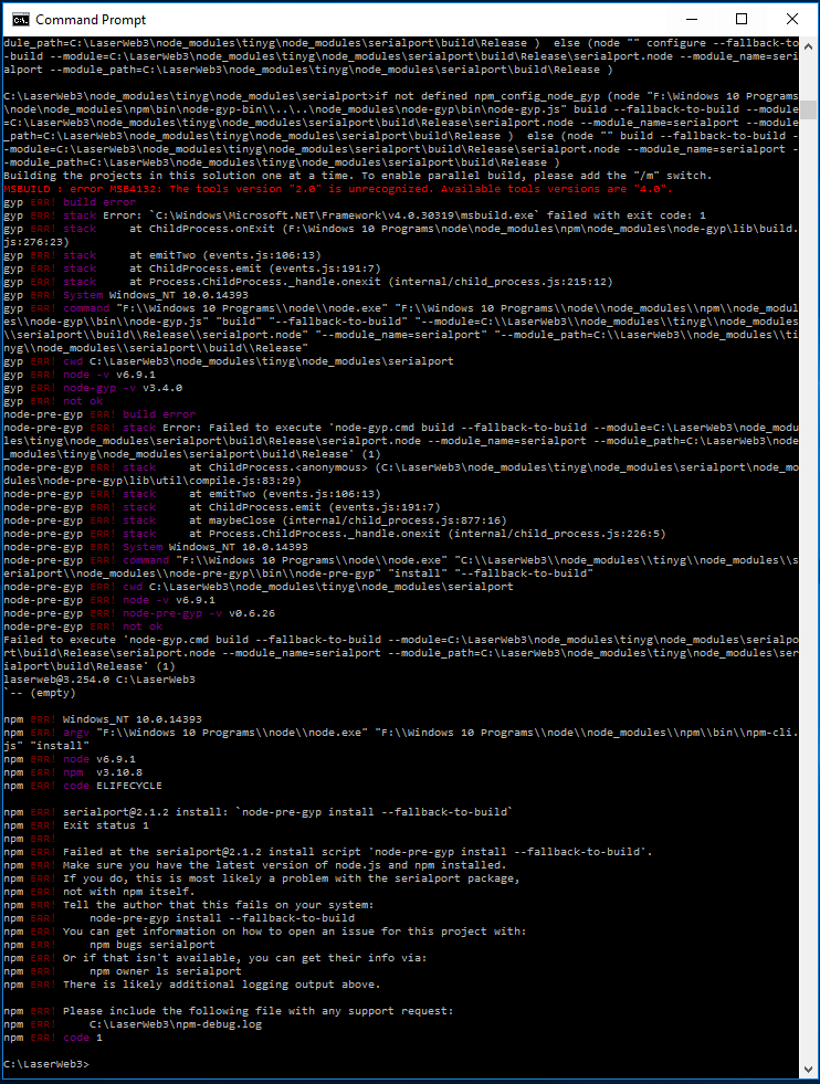

I am now running a clean version of windows 10, have python 2.7 installed and directed to the proper folder. I tried using npm install serial and the output was “C:\LaserWeb3>npm install serial
laserweb@3.254.0 C:\LaserWeb3
`-- serial@0.0.9” my cirrent errors are in the picture with this post
npm version is 3.10.8 and node is 6.9.1 using the -v commands
Is there a better command to pull it from other than “git clone https://github.com/openhardwarecoza/LaserWeb3.git” as I did that just a little while ago on a clean install of windows 10 +Peter van der Walt. Sorry to be a bother, just keep hitting road blocks.

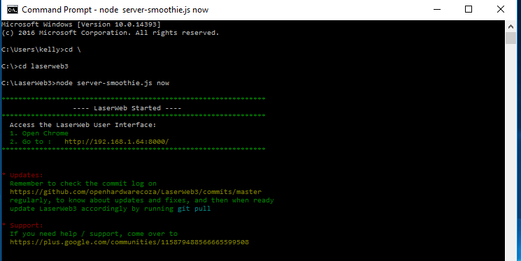

oh hey think we are onto something.
"C:\LaserWeb3>npm install serialport@latest
serialport@4.0.6 install C:\LaserWeb3\node_modules\serialport
node-pre-gyp install --fallback-to-build
[serialport] Success: “C:\LaserWeb3\node_modules\serialport\build\Release\serialport.node” is installed via remote
`-- serialport@4.0.6
C:\LaserWeb3>" Will try again now
