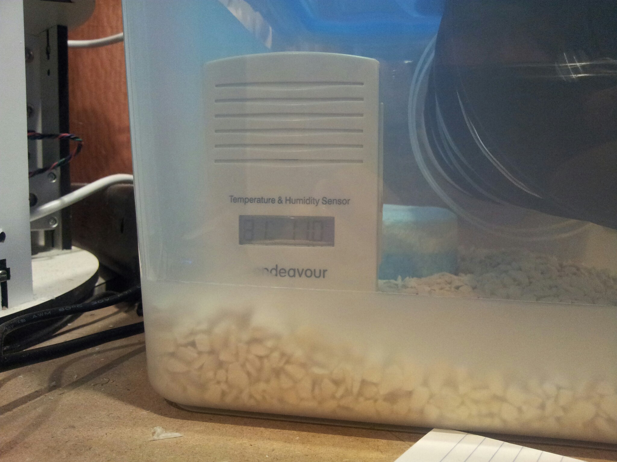

Help! This dry chamber isn’t working at all. 80% in and out. Any ideas for tests?
Your dessicants have to be dry to start out with. They don’t so much remove humidity as balance humidity. If the dessicant has been in an 80%RH environment, it will release moisture until the local environment and the dessicant equalize.

Are you using calcium chlorid as desiccant? Than you should achive much lower humidity even with your unsealed box. With my sealed box I have less than 15%
Is your humidity meter working? If you breath against it is humidity changing?
@Marcus_Guin_Klutmann I’m not sure what the desicant is, something like “damp rid”. The chamber is quite well sealed except for the very small clearances between the ptfe and the 1.75mm filament.
@Marcus_Guin_Klutmann the humidity sensor does work at least +/-8%

To @Tom_Martz 's point, I originally put damp rid in a gallon zip lock bag with a spool and water accumulated at the bottom of the bag (actually surprised to see like 1/2 oz of water in the bag). I then moved to a large sealed container and am using the damp rid in a container, which is basically a cup with damp rid at the top in a tray to allow for water to accumulate at the bottom.
@Tim_Sills I think perhaps my mistake is that I’m letting the water drain into kitty litter below and perhaps that its just evaporating back into the chamber.
