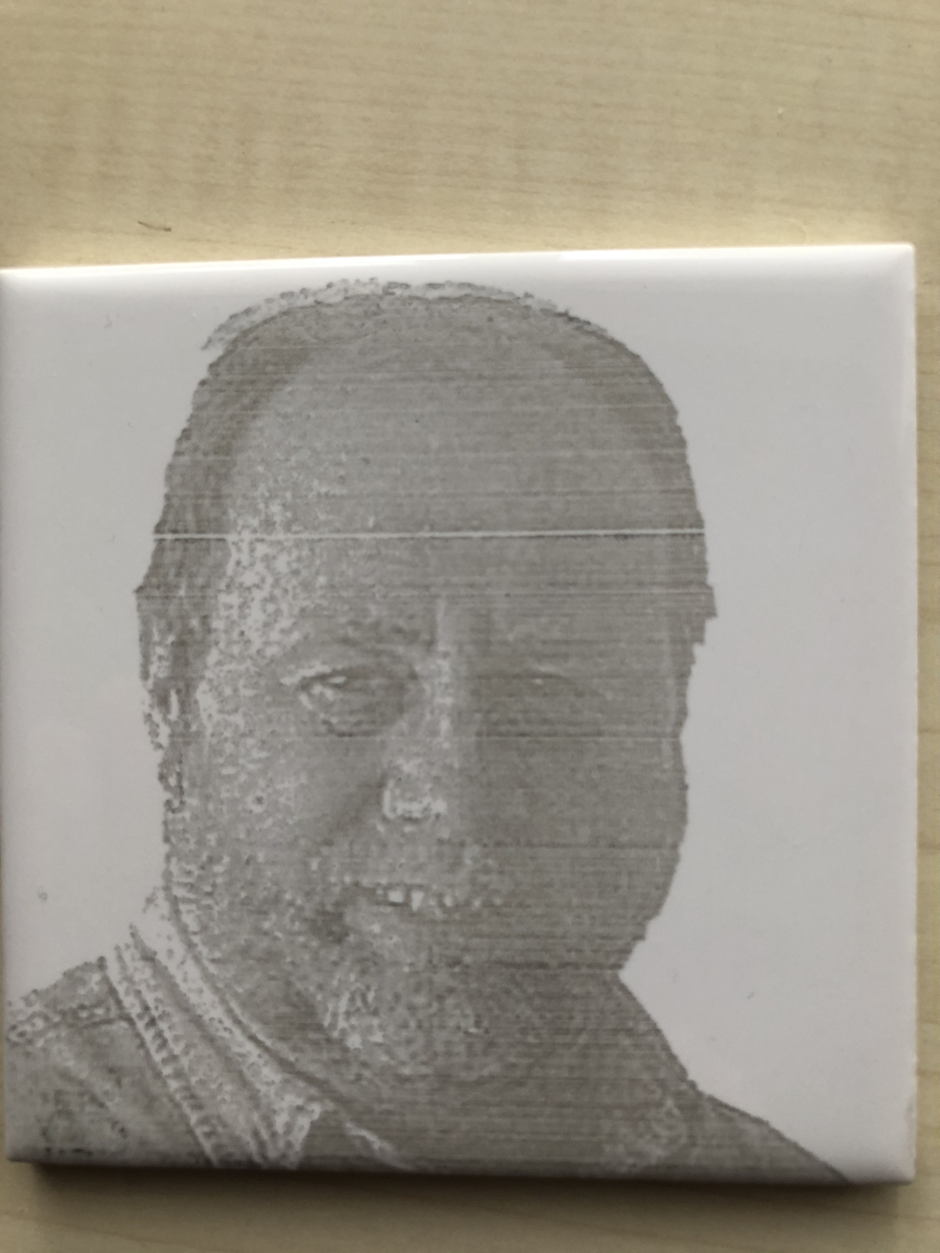

  3. From this photo of a Rasterized scan you can clearly see a white line going across my forehead. Any idea what might have caused this?

  3. Looks like the y-step skipped.

The forehead line might also be banding if you have some devices like an air assist that turns on a compressor here and there on the same circuit, but it’s usually more of pronounced banding.
