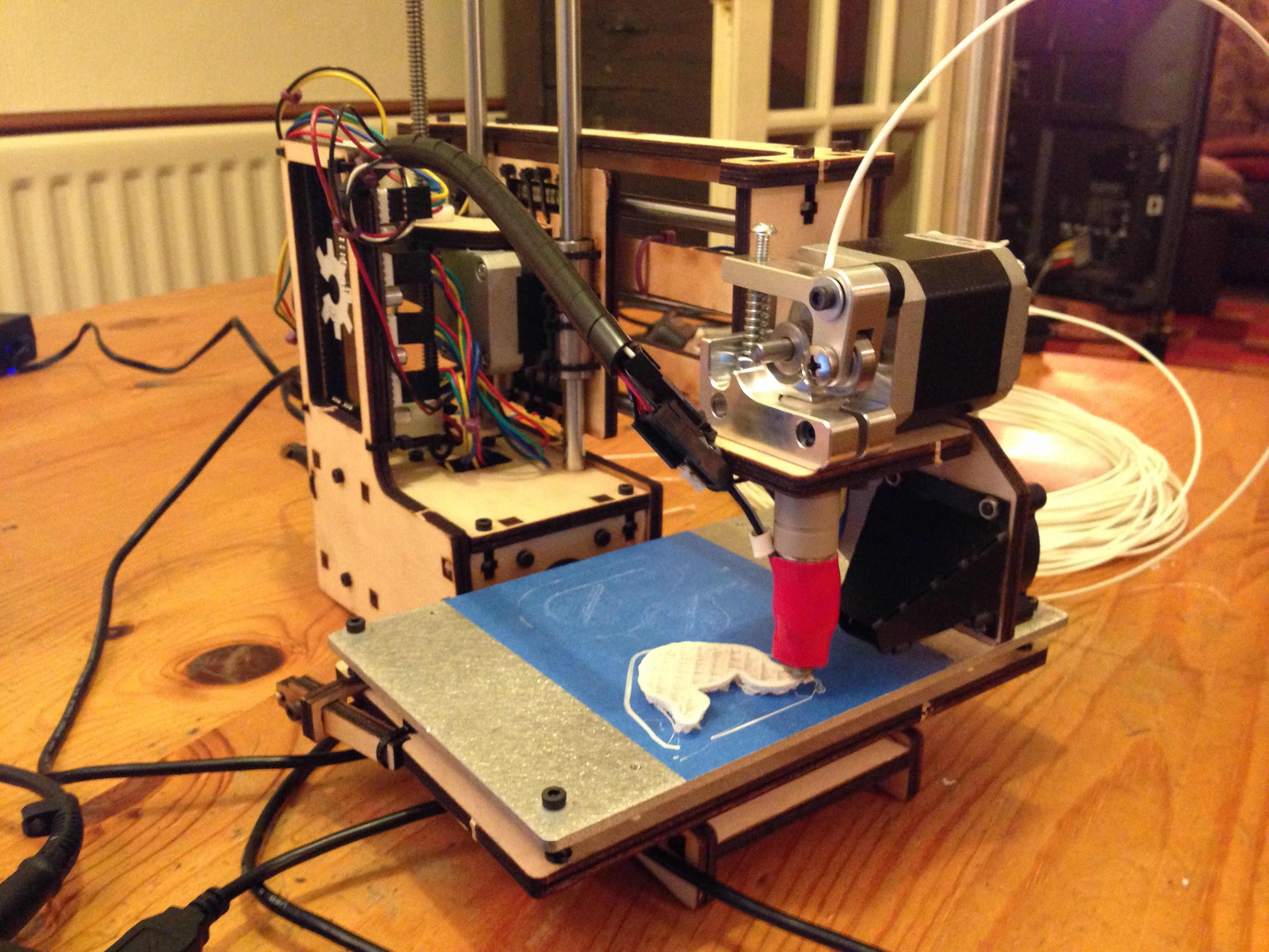

Helped a friend get a printrbot working for his twins today.
Helped a friend get a printrbot working for his twins today. The simple makers kit certainly has some poor aspects, but it’s damn good at that price as a taster to see if it’s something they will be into.
I’m not keen on the sandpaper pulleys, the quality of the string used to drive the axes, the wiring in general is derp, and this ones extruder is a pain as the supplied spring is too short and there is no method of adjusting tension without packing washers. Also the software config is very fiddly. And you expect soft end stops to be set up to stop you ceasing into the max position.
Impressed by how well slic3r works with it basically out of the box though.
Many of those things have actually improved on the newer Maker Kits (1405) - that still doesn’t make it a top-notch printer, but it’s rapidly getting rid of shoddy solutions like the sandpaper “pulleys”.

I bought my Simple just before the belt drive, z-probe, bigger z-stepper upgrade - sigh - that was an awesome upgrade and at no extra cost!! But that is life - no time for regrets. I bought a belt & pulleys somewhere and have printed the parts to make it bigger & better.
First thing I printed was filament guides - http://www.thingiverse.com/thing:75002
I was having issues with heat creeping up the hotend and causing jams. A printed fan mount (http://www.thingiverse.com/make:79467) and an extra 40mm fan appears to have solved that problem - I wonder if somehow the fan cooling the print could be shrouded to also cool the extruder?
Another tweak I made is a power switch on the unit - not sure if you’ve added that or not - http://www.thingiverse.com/thing:441995
One last issue I have that I have not got around to solving is keeping the printer from walking around when it prints tight infills. The vibration causes it move - maybe some rubber feet?

I have the same printer and can’t say a nice word on it. I had to make a lot of modifications to get it kind of working. I found a fishing line in an outdoor store, that claims to be the strongest fishing line on earth and folded it 4 times and turned it 3 times around the sandpaper drum. No slipping and it broke only once. Then I made this https://www.tindie.com/products/FemtoCow/printrlight-light-and-extruder-fan-holder-for-printrbot-simple-2014-2/ to combat extruder overheating. Because without it I couldn’t print anything that would take more than 15 minutes because the filament would get soft and jammed in the extruder.
Oh, and the Ubis hot end, I have fourth one already. One of them broke just after 40 days and they refused to exchange it because they give only 30 days warranty. They used to have a description on the hotend page, how is it the best hotend in the world because it’s made by Jesus himself after working for 20 years in HP test lab, LOL. If they only put their money where their mouth is. 30 day warranty says it all about what they REALLY think about quality of the product they make.
The string and sandpaper works surprisingly well. I’ve upgraded to GT2 belts and not noticed a massive difference except it’s noisier now.
This is a great addon to prevent extruder overheating and filament jamming due to getting too soft https://www.tindie.com/products/FemtoCow/printrlight-light-and-extruder-fan-holder-for-printrbot-simple-2014-2/
