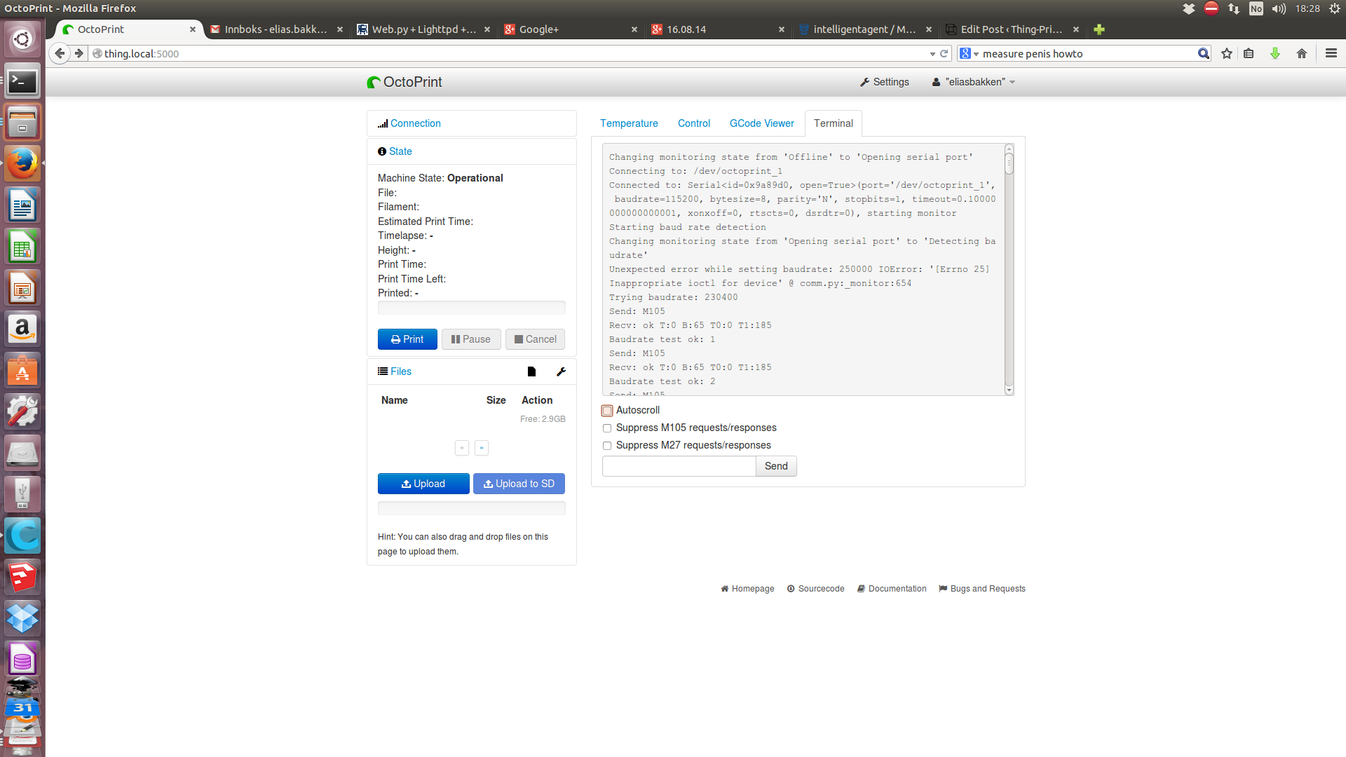

@Henrik_Peiss This is what my connection information looks like on Octoprint. Tried a reboot, everything looks good with the latest image…
I just borrowed I duplicator4 to have something to try the Replicape board in. I got tired of boy being able to join in the fun.
Seems like it is a config file problem, because redeem isn’t starting after config files mod. That seems to be the reason why Octoprint isn’t able to connect to the virtual port offered by redeem. What is the best way for solving the config file problem: look on redeem.py and the config file in parallel?
I expanded on the web ui yesterday, so you can edit config files and restart redeem from there. Ill package it and upload once I get in to work!
@Henrik_Peiss could you try the new UI?

Sounds great.
Will be back at my BBB in a few hours. Will post my findings.
