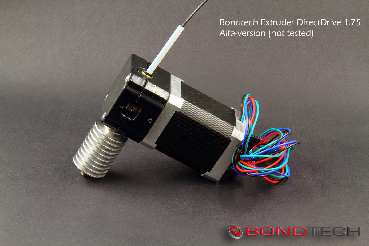

In the following images I show you some more units, direct-drive for 1.75 with an integrated mount for an E3D-nozzle, a unit for 3.0 filament with a planetary gearbox with integrated mount for an E3D-nozzle. The last one I have plan to replace the existing extruder of my heavily rebuilt K8200 printer. The performance of this printer lead me to start to develop my own since the design of the K8200 has a lot of design flaws.
