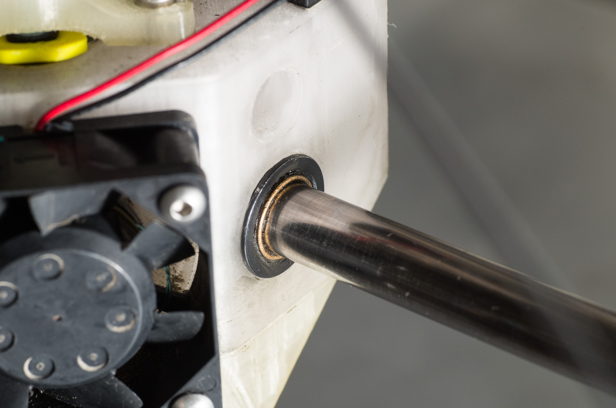

Here are some photos of the cracking. @Dennis_P was asking me for some pictures and thought the rest of you might be interested too.

Looks like the clear abs Walter printed with for his parts. I never tried that material, but it looks like there is a combination of stress, low strength plastic, and undersized holes. Also when softening the bushing pockets with acetone, it takes a lot of applications with the qtip to get more than just the superficial surface to soften. Also it takes a long time to cure back out before you will want to put any stess on the ABS.
I think unless you are enclosing the printer PLA or PETG might be a better candidate. I have an odd preference for ABS… but then again I have a large enclosed printer, and I am old school enough when it was one of the only two options to choose from
We modified this as the price of the selfcentering bushings is horrible here. We took 30mm Graphite-Bushings (aliexpress) holded in a self printed TPU-Sleeve and it works flawless since a year now (heavy duty printer) without cracking or other up to real 500mm/s.
@Eclsnowman up it’s the translucent black abs. Very cool color, but I’m thinking that I likely was printing them undersized.

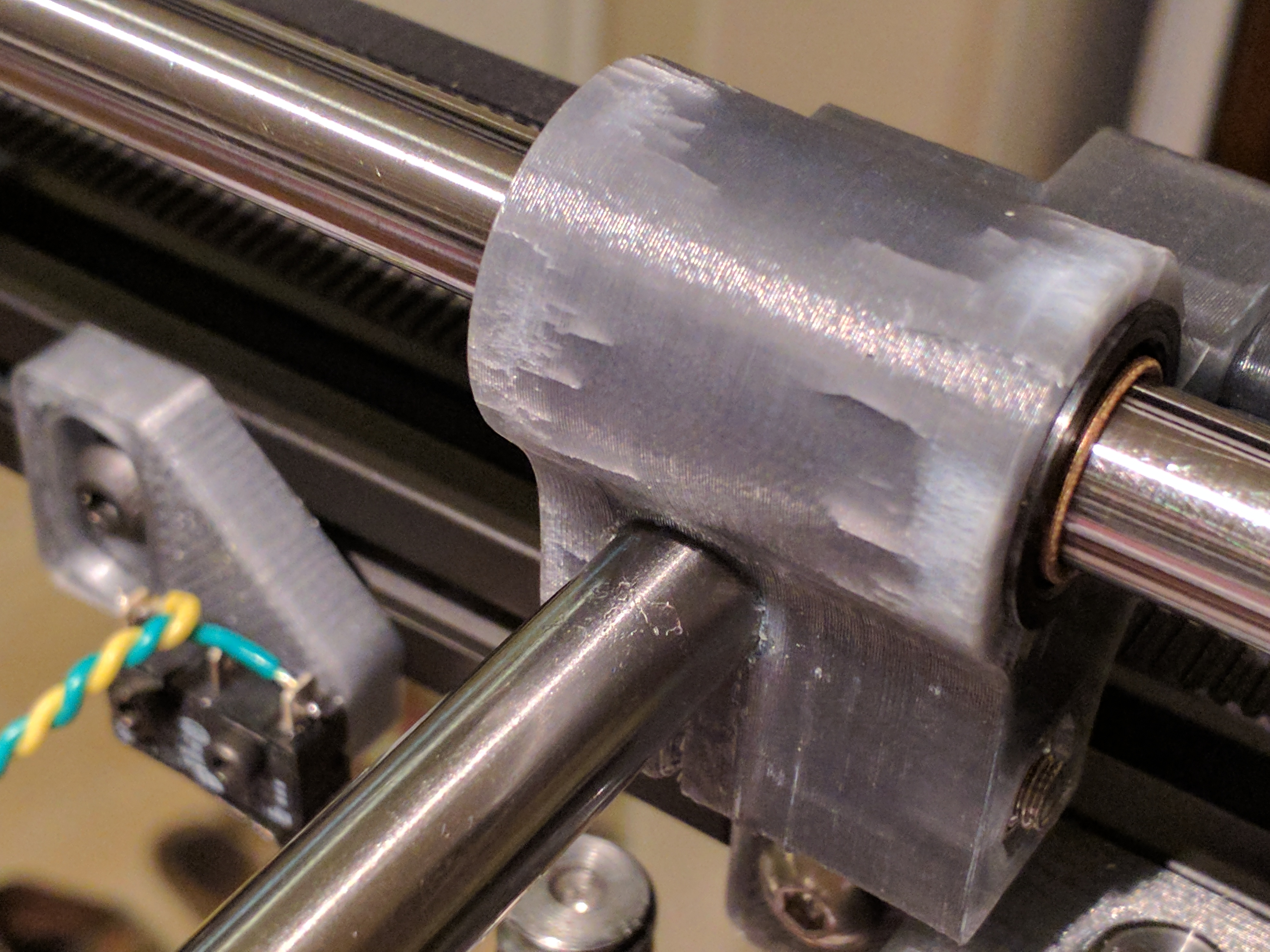

Yeah, I’ve found the transparent ABS filaments crack under stress and behave very differently from the opaque ABS filaments. I just added a couple of example pictures to a brief blog post I put up a while back - http://thrinter.com/part-failure-1-crazing-cracking/
My rod holders printed out of the same plastic are still holding up, but the z-rod clamps cracked fairly quickly.

WOW! That looks like classic hoop stress. How tight were the bores that you put the bearings in? In reflection, I ‘goosed’ my bores with a 1/2" diam sanding drum on the dremel to clean up the supports after printing. I wished I had a sharp 5/8 reamer to run down them to make them straight and to size. I used one company brokered through 3DHubs. It was pricey. Then I discovered my library had one for supervised public use.
