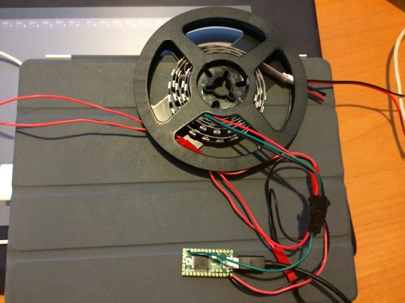

Here are the photos
Here are the photos
You’re weired to AGND instead of GND - try wiring to GND. I’ve had weird stuff happen when wiring ground to AGND instead of GND.
Thanks, I’ll try that, though I thought they were mostly equivalent.
OK, so I may have been wrong about ALL of the LEDs being blue. It looks like the first LED is off and the rest are blue. Rewiring ground to GND from AGND did not make a difference
More information: Even if I try to control more than one LED, only the first is off with the rest bright blue. I’ve also tried changing the setup to use the WS2812B initialization with the same result. Here is the entire code that I’m trying to run:

Oh! Important question - what version of the library are you using, the teensy 3.1 is only supported on the 2.1 branch, not master.
FastLED2_1. Yeah, I saw that before I ever started down this path. I do appreciate the help. I’m sure I’m missing something here, just can’t figure out what. A bit more information. If I don’t use the FastLED2.1 library, and just run a simple program that doesn’t try to light any LEDs, I still get the same result - all Blue LEDs except for the 1st. I’m hoping that the first LED isn’t bad, but I can probably deal with that if it is. It just means cutting it off and resoldering the leads.
Thanks again Daniel. Let me know if you can think of anything to test the setup out. I do hope that I haven’t chosen a bad LED strip (i.e. one that just won’t work with this setup).
I’m not entirely sure what you’re seeing. I’d think if the first led was bad, none of the other leds would light up. Also - I quite often use a teensy 3.1 and WS2812 strips without issue.
One possible idea - you’re currently running at somewhere along 300-400 fps. For laughs, what happens if you change the delay to be 5000 (e.g. 5s). There is such a thing as running the WS2812’s too fast.
Though, that doesn’t explain the coloring on the rest of the leds, they should all be off.
Tried it - no change. I’m really confused at this point. :frowning:
So am I. Out of curiosity - can you try running off of a pin that is not pin 11? Also - i’m finally digging all of my led stuff back out after burning myself out on a project for Priceless - and will be poking at the teensy 3.1 again this weekend. It’s possible something horked got in there :frowning:
Sure Daniel. What pin would you suggest. I chose 11 because it is listed as DOUT. I’m willing and anxious to try anything to make this worlk.
Wait a minute. I think I’m an idiot. I may have wired to the back end of the strip instead of the front end. Let me try to correct that first.
Yep - that was the problem! Woot! Thanks for the help Daniel. It’s functioning properly now!.
