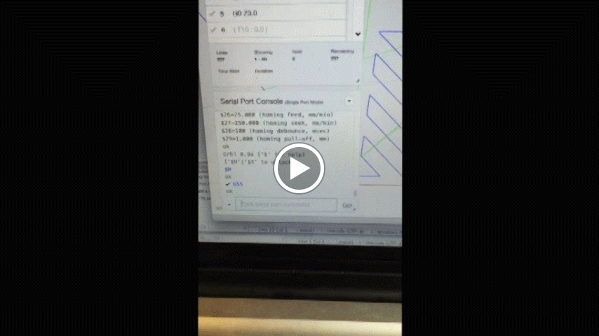

Here I'm cutting one face of four cubes.
Here I’m cutting one face of four cubes. I’d like to do 16 in one go but my stock Sh1 is slightly too small.
I took the G-code for one block and then copy-pasted it together with judicious use of the G92 code to change the origin between blocks. Works great, although ChiliPeppr sometimes gets confused as to where the bit actually is.
What’s not seen is the “oops” moment when I’m doing another face and forgot to copy-paste the retract motion before I do my re-origin, so I have a bunch of Zorro blocks.
Endstops (well, really just homing stops) are the best upgrade I made to this machine.
So I didn’t go out of my way to turn on image stabilization. Not sure what part of my toolchain did that.
