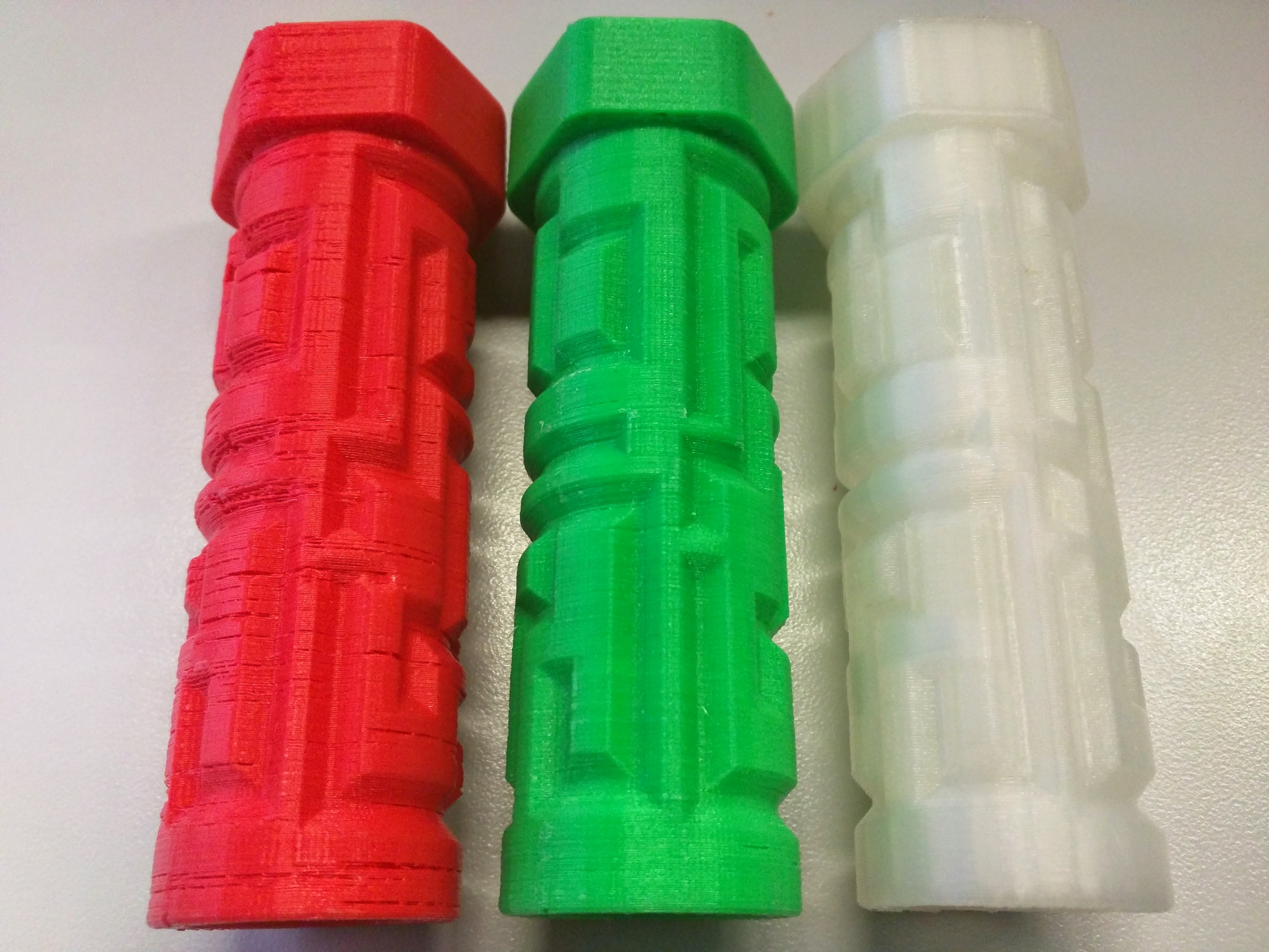

Here is a comparison print of the same object: Green:
Green: The first print of a brand new extruder on a Makerbot 5th generation.
Red: A handful of prints later on the very same extruder on a Makerbot 5th generation.
Clear: The first print of a brand new Printrbot Simple Metal without tuning.
I have since gotten better results both on layers and rafts for my Printrbot Simple Metal. The Printrbot Simple Metal is $600. The Makerbot is $2900. The only thing you gain with the extra $2300 spent is the headaches.
