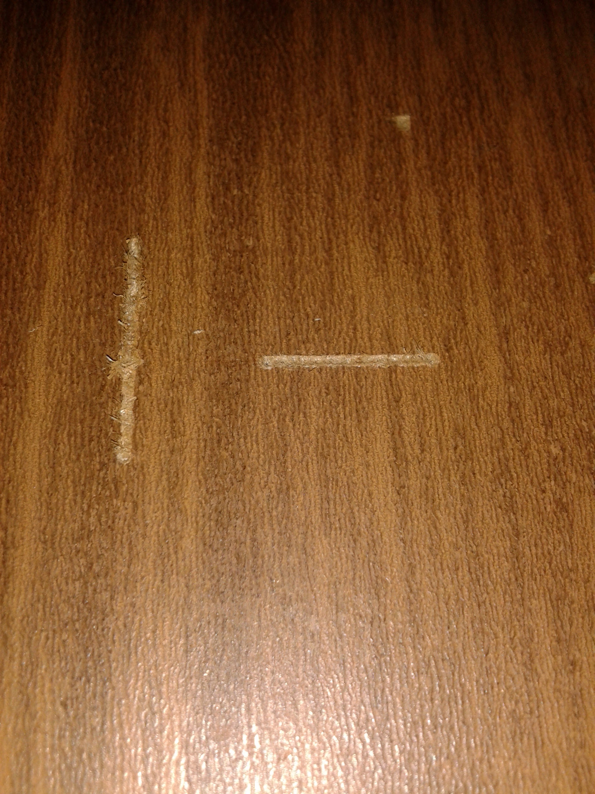

Here is a new dremal mount I made,
Here is a new dremal mount I made, this is for the little Fred Myers dremal’s. I had two of them lasting around so I figured id try a mounting bracket out.
I’ll put the files up on thingiverse and youmagine here in abit.
Now to have it do something useful. What can I use to control this head?
