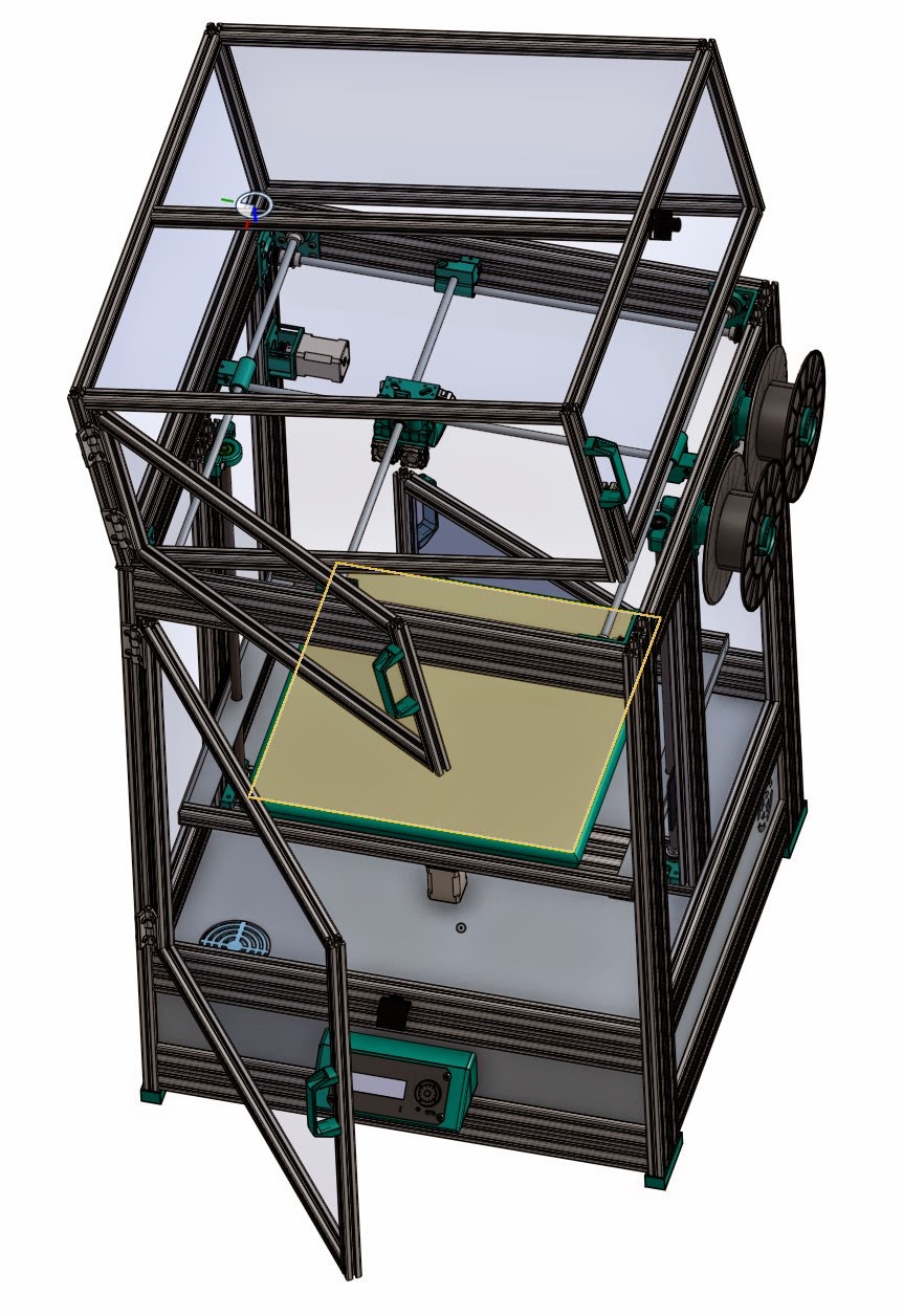

Here is a sneak preview of my Herculien variant…
What did you vary?
It has bigger print volume (estimation atm is 425x425x500mm) the motors are on the inside of the frame
Looks great. Can’t wait to see more.
FYI, it looks like the upper lead screw supports are upside down.
yeps I know
- some minimal adjustments still going on. but the basic concepts seem to work. Need to place the endstops for x-y, and some other smaller parts.I’m working on the electrical compartment atm. Still long way from starting to print though
