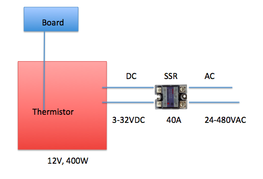

Here is a SSR wiring to the heated bed. Comments?
With this, can I still use bed PID?

Not the way to wire it up. I use PID.
the SSR is powered by the normal bed 12V ouput of your board.
it goes : ArduinoBoard → SSR → heatbed
you connect the bed in series with your power source… (one wire to the bed from the power source, the other one goes to terminal #1 of the ssr, then terminal #2 of the ssr to the heatbed)
this is on high end side (24-480AC if your source is main’s power)
the low side (3-32DC) is wire to wire with the + & - of the arduino board. they are marked so you can’t go wrong.
Don’t forget to also jump the bed input with your power supply’s 12V
Has your picture, if the bed is also 12V DC then you need a DC-DC SSR. (the one in the picture with thoses specs is for AC voltage)
then you simply split the power supply’s power in two… (one for the board and one for the bed)
This is the model you need… look at the picture… just don’t use this one for main’s power. http://www.ebay.ca/itm/Solid-State-Relay-SSR-40DD-40A-5-60VDC-3-32VDC-/141023030534?pt=LH_DefaultDomain_2&hash=item20d5a0ad06

Sorry, I replied with the short comment so I could get you stopped before you did anything dangerous. I needed the time to create a diagram: http://i.imgur.com/TsoUdHF.png
@ThantiK @Jean-Francois_Coutur thank you. The image helps a lot.
I tried something similar to this a few weeks ago after I found a schematic on a spanish? forum. Didn’t understand a thing, thought I would just try it out. Turn bed on, BOOM! 0-200degC in 2 seconds. I had my finger on the switch just incase and hit it just in time, so there was no lasting damage to my alu bed. Lesson learned, be careful with AC, don’t be stupid haha!
@BoonKuey_Lee , make sure the bed is matched up with the input voltage of the outlet. Also make sure to use the right kind of connectors so that no metal is ever exposed anywhere (your SSR should have a cover); you don’t want this touching a metal frame, etc. Take proper safety precautions. Use terminal blocks/connectors like this: http://www.adafruit.com/images/1200x900/677-00.jpg - which have all of the screws/connections recessed to prevent shorting. And install strain relief everywhere there is a moving wire.
Looks like DC is safer. I can also go with DC To DC having a separate 24VDC supply. Good option?
Yes, I use a 24VDC supply that I tweaked to output 30V (of course just for the heatbed).
