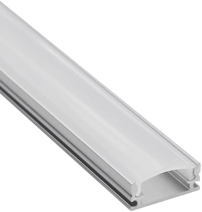

These are $14 per meter (or less in larger quantities), and they work well for mounting and diffusion.
@Jason_Coon . That is actually on the expensive side – these are a little under $6/meter and work well in my experience: https://www.amazon.com/gp/product/B01JZ7GK9S/ref=oh_aui_search_detailpage?ie=UTF8&psc=1
@Dustin_Yoxall do you have access to a router? If so, just get a sheet of plywood, route 3/4" grooves in the plywood, paint the plywood if you like, then put the aluminum channels in the grooves with liquid nails, and voila.
