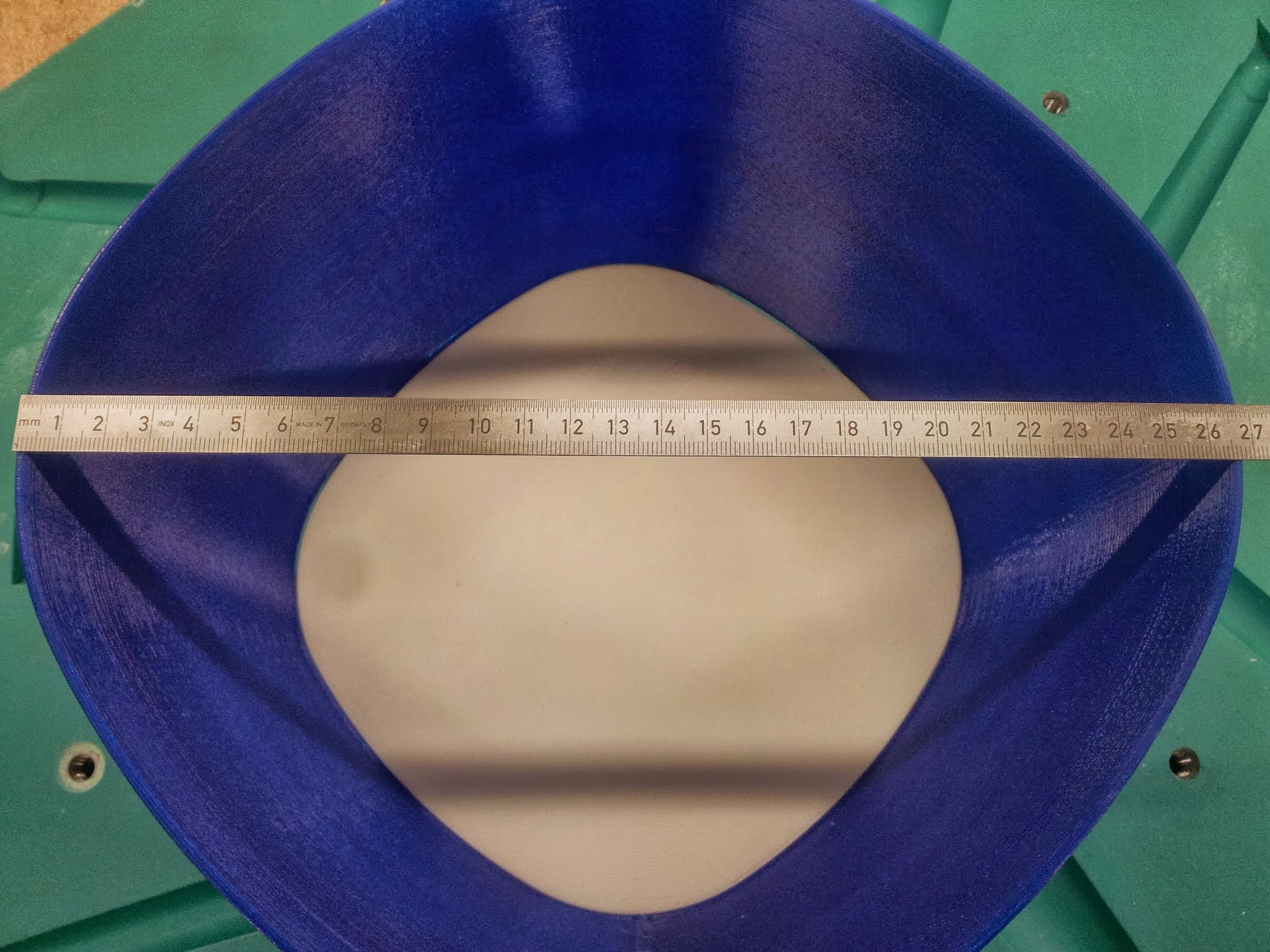

Here is just to show the power of a delta.
Here is just to show the power of a delta. Maybe a reply to the discussion about changing resolution across build platform. This job came just in time to see if it shows, and guess what, I cant see any problems whatsoever, and this print was really really tight squizee onto the work space. As you can see its not all about the resolution, its more about repeatability.
Otherwise, this is a print for customer, so I cant share any more pictures/details, but its getting a paint job so the customer can evaluate the design as its goona look out of production before making a mould for injection moulding. One more interesting thing, its 100% filled. This is one of the demands we get quite often, so the customer can evaluate both the real weight and also mimic strenght of the part.
Thanks for the pics. I expected to see the kind of distortion of the layer lines that can be seen in the second picture, but nobody’s ever posted a good enough picture to see them before.
You`re welcome @Whosa_whatsis , but I think this is something to do with the slicer, kisslicer actually. I get this pattern on just about any size print. The @Johann_Rocholl python script of cleaning g-code from kiss gets rid of this, but then Im getting stringing/blobing. Just never had the time to sort this out. Cura on the other hand doesent produce these, neither slic3r, but kiss is all round winner for my work, it gets job done everytime and this pattern doesent really bother anyone, one can hardly notice it.
What is happening that @Johann_Rocholl 's script cleans up? I’ve recently started using KISSlicer and mostly like it; but I feel like I am still fighting it some.
