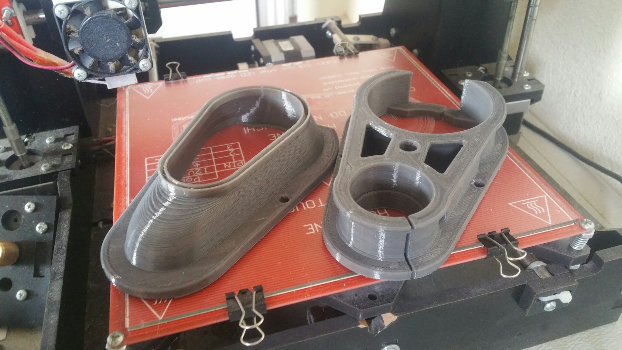

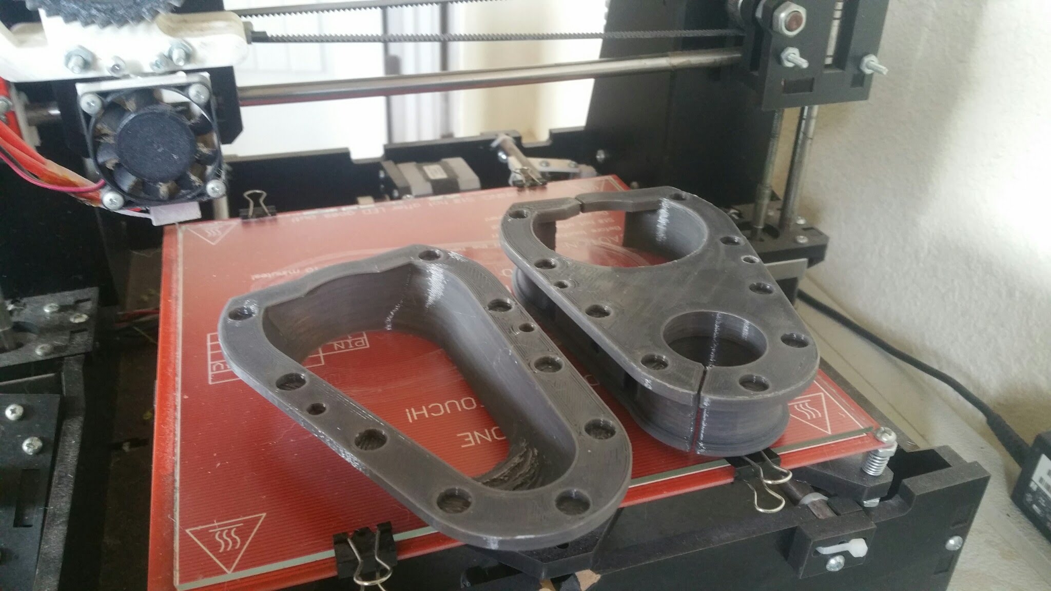

Hey Jeb Thanks for the stl s. They came out well in pla. Lets hope they can handle the vibrations.
Magnets came in today. Havent gone to PO to pick them up yet.
@BuddahrobSidartha_Ro Glad you got it printed. Looks like you have a bit of under extrusion, but it will work fine. I like the shine, which PLA is that?
This helped me get dialed in:
https://www.simplify3d.com/support/print-quality-troubleshooting/
Yeah its a be leveling issue.
