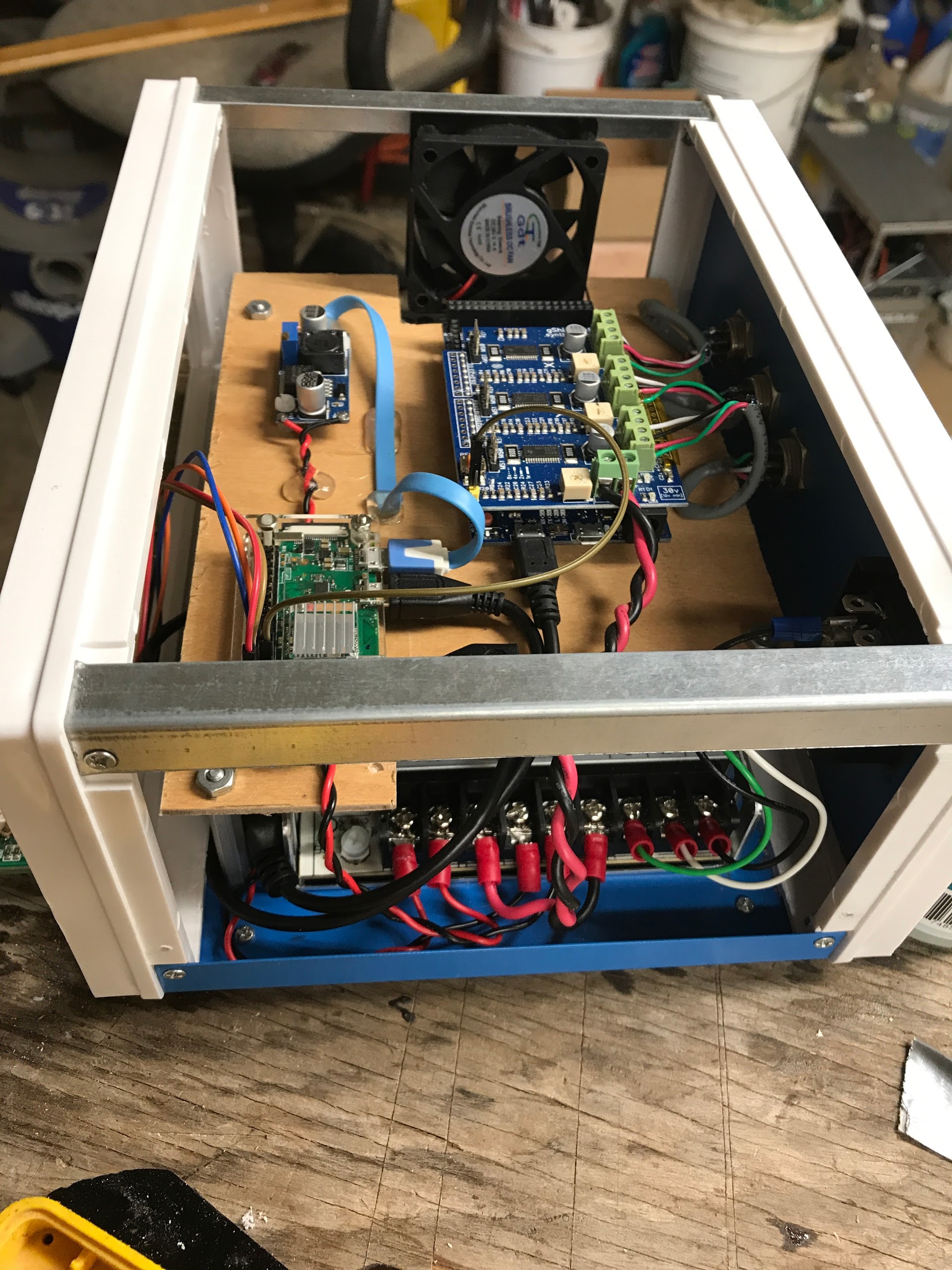

Here is my Taig Mill controller built with gShield + Arduino Due + Raspberry
Here is my Taig Mill controller built with gShield + Arduino Due + Raspberry Pi Zero W + Crystalfontz LCD + Meanwell PS. It runs my mill 2x faster than its original Mach3 parallel port controller. I was planning to use it with Chilipeppr, but I am switching over to CNCjs because I was having too many problems with CP.

When you get a chance, describe what the role of the RPizero and LCD are
https://github.com/synthetos/g2#g2core---edge-branch
Answering the last, and easiest, question first:
The Pi runs the CNCjs server app (or spjs but more on that later). I connect to it over WiFi with a PC in an other building (same network), a tablet near the mill, and my iPhone as needed.
The LCD currently reports the overall system state - booting, on-the-air w/ IP address, app started. I could have done that with a few LEDs - apart from the IP address report - but I had that LCD left over from an ancient project and “what the heck” ensued. I hacked spjs to report incoming connections and serial port connection status on the LCD - very useful given all the ways that connections can drop and browsers crash. I haven’t done the same yet for CNCjs but my CNCjs development fu is approaching the point where I should be able to do it soon. I have a back burner plan to use the LCD keypad for something - probably EStop and maybe simple jogging for getting the spindle out of the way to do fixture setup or maintenance.
