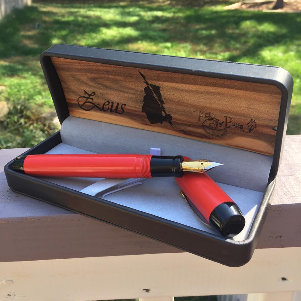

Here is one of my box lid inserts finished up today. Each one is burning a bit better than the last as I tweak the file and power/feed in LW3. I also have it doing all of the operations in one shot now. A vector outline, a raster engrave and then a vector cut. Happy days!
The pen engraving itself still leaves a bit to be desired, but I think that’s on the hardware configuration right now and not a software issue. But it’s definitely better since switching over to the cnc firmware for the board.
@raykholo Yep. I’m actually going to play with the source a bit. It may be some combination of the font and size. I’m going to try a line font of some sorts and try this same font larger to see if it goes away. I don’t see it on any of my larger vector stuff.
