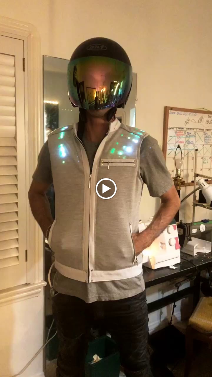

Here is the end result of the led vest. Such short timeframe to make and you guys helped out quickly. Any Burners here may see it in Nevada too. The code is in my earlier post if anyone is interested.
The designer and creator of the vest is from Daniel. He designs apparel and costumes for clients all over the world. http://dcheli.com - May all your dreams come true…… mine have! #performer @kozmiktwinz @dcheli @c…
Parts used teensy 3.2, octows2811. This platform has never let me down.
I think it looks extra cool when the pattern is broken up enough that you don’t really notice the individual 8x8 panels.
The diffusion from the cloth looks good.

. What is your power supply?
@Patrick_Aversenq pocket juice 20000 mAh power bank @5v. supplies up to 2.1 amps per port (2 ports) volt meter was showing about 1 amp peak per side. I used the fastLED brightness setting at around 50 but noticed I can run it much lower and use a fraction power. I setup two buttons one for patterns and the other for brightness toggle
