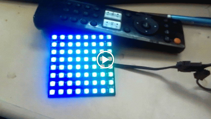

Here is the stock NoisePlayground Example sketch with:  kMatrixSerpentineLayout  false Both of these videos
#define kMatrixSerpentineLayout false
Both of these videos have the master brightness at 45, but the bright lines are extremely bright.
Play around with the brightness. Mark and I are going to be tweaking around the octave stuff to cut back on some of that a bit - but basically brightness, right now, likely needs to be adjusted as you increase octaves. (Now that i’ve got the basic stuff running with this - I’m looking to make frequency/amplitude passed in options as well)
Ok, I set the master brightness to 25, and the brightness at it’s peak is closer to 45 now.
