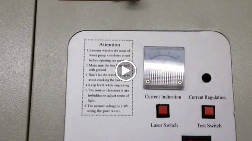

Here is the video of what’s going on. Am I not supposed to keep firing laser continually?
Is that why the power I’d dropping?

Check all your grounding, the outer shouldn’t drop like that even at 100%.
@Scott_Thorne Yeah I checked everything again. Also made sure the machine ground wire is properly attached. But its still the same. However if I run the laser at 43 power with ppm value seems like it stays up there instead of dropping.

Is the discharge in the tube changing appearance as the power fades? That will tell you if it’s indeed changing. The color can be an indicator of a leaky/contaminated tube as well. I’m not sure of the specifics, There’s details on that on the CNC forum.
@Scott_Marshall yeas when it outputs full power ie 9-10mA I see bright purple lights and as soon as power drops it gets dull and less dense.
I think the bright purple is bad. Let me see if I can find the details for you.
