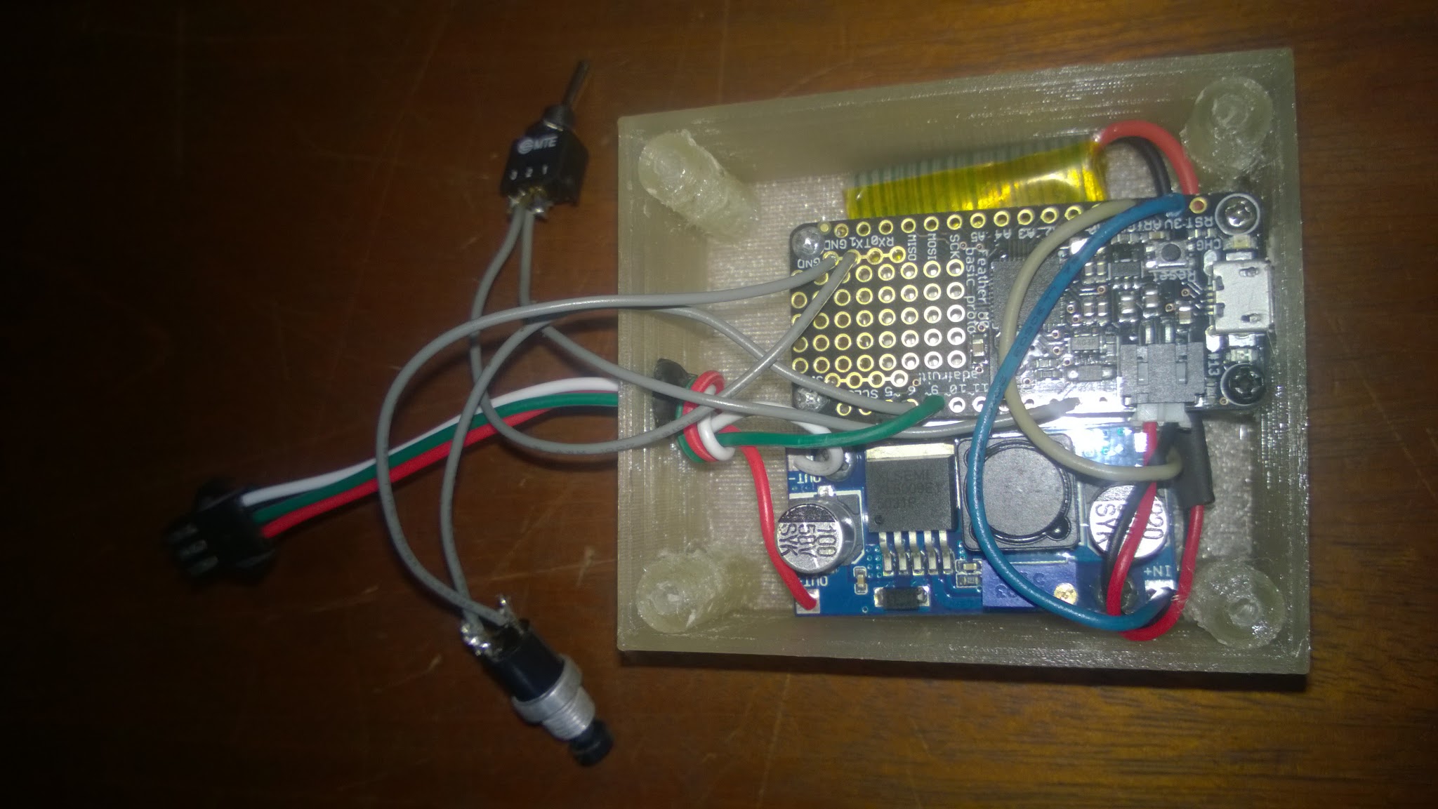

Here is what I was talking about last post.
Here is what I was talking about last post. I will upload 3D print files to Thingiverse. But since I have this power issue I am going to have to use a different power booster and redesign the case and layout. But I just wanted to share my pictures of what I have so far. BETA Version 1.0
RGB LED Strip Tester/ Portable Unit. Version 1
(Works depending on how many pixels and battery percentage and code)
This is my first Feather Project. So I have found a few flaws in the board that is acceptable. One The charge indicator led isn’t bi-color for knowing when your battery is fully charged. Second There is no hook up for a switch for power on board like you can in a backpack. So then you have to hook it up on the main so in order to charge the battery you have to have it on. Although I can always remove the built in JST and place in the backpack and solve both of those issues. But I don’t want to spend any more money or add anything extra to this project. Unless alot of people think I should?
