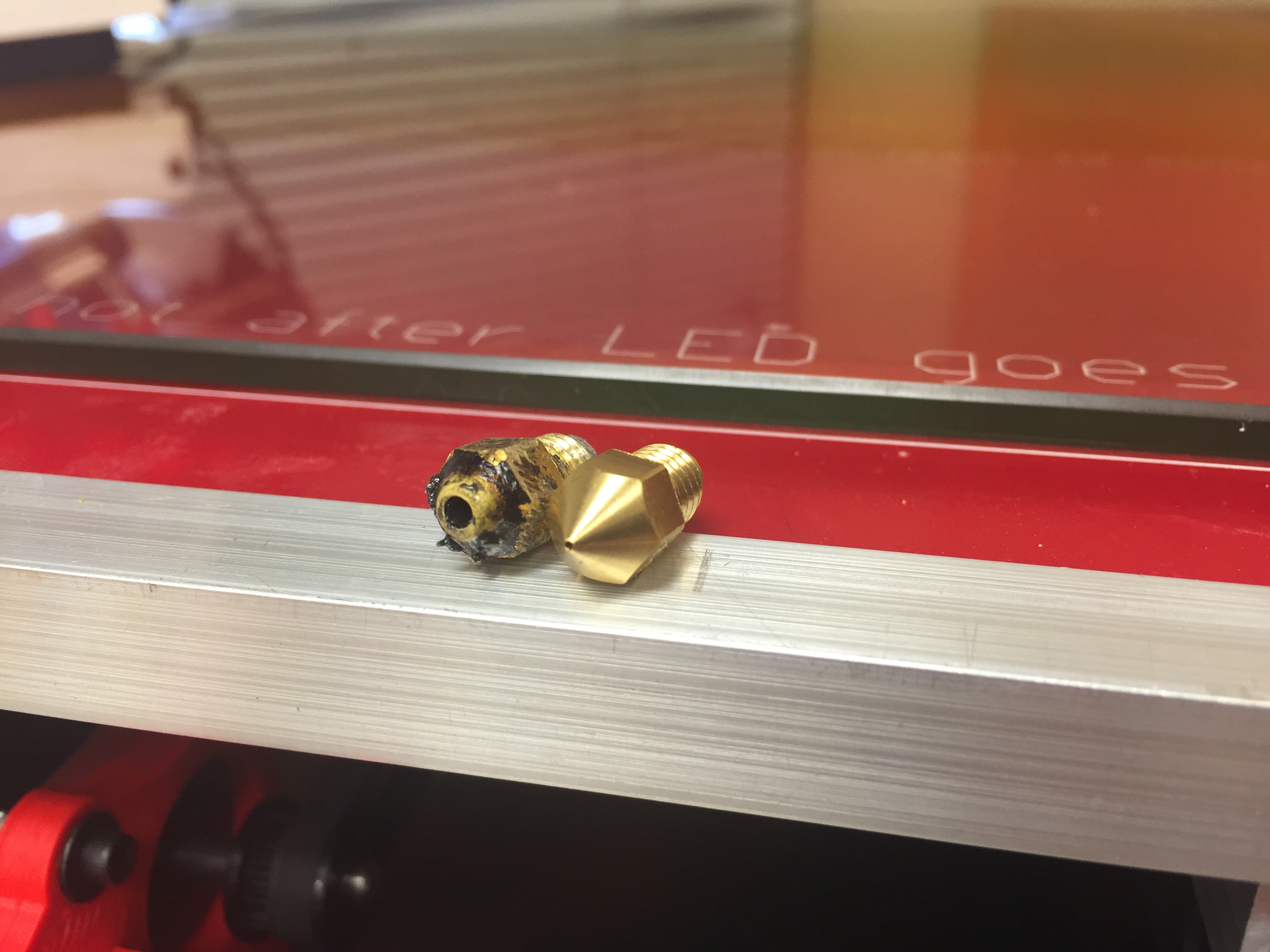

Here is what printing a 750g spool of 3dx cfrabs does to a brass nozzle.

That genuinely started out the same diameter?

Yeah they’re identical nozzles… or they were anyway. Unfortunately the Pico hotend I have only has brass nozzles available.
That carbon fiber is pretty abrasive!
Well, I guess you have a fat nozzle for fast printing now.

@Bradford_Short I ran about 400 grams of 3DXtech CF ABS through my E3D V6 1.75. There was significant wear but nowhere near what you experienced. http://i.imgur.com/IWJVFLM.jpg and http://i.imgur.com/R2QCjIz.jpg Maybe B3 uses a softer alloy.

If that filament is the abrasive I’m amazed it didn’t jam a ton. Particles must’ve been really large
