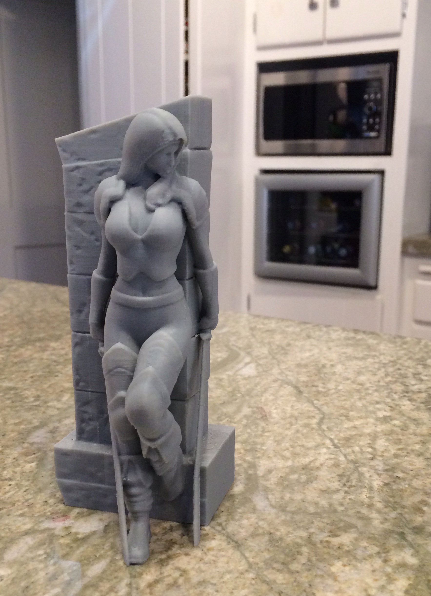

Here it is after a little heat gun work

so what is heat gun work exactly? Your print looks amazing!
a heat gun is used to soften the material just enough to blend and hide the layers

@Jonathan_Haberman Where the print was on the raft or where support touches the model it tends to leave a white mark on the ABS, buy using a heat gun on it for a few seconds it makes the white go away.
@Jonathan_Haberman Probably not necessary
@Daniel_ShadowDrakken I only used the heat gun on the base where it was attached to the raft and where support touched the model, otherwise what you see is how it came of the printer.
Would you say it’s producing better prints than your UP!?
Equal to and in some areas better. Bigger build platform and producing these prints with beta firmware and software so no where near full potential. UP Plus still excellent printer.

Not sure what the temperature is, but this is the one I have http://www.amazon.com/ECG-HG-300D-Mini-Heat-Gun/dp/B003N3G4WY/ref=sr_1_8?ie=UTF8&qid=1391446525&sr=8-8&keywords=HeaT+gun
Beautiful print.
I use setting two
PLA or ABS
ABS
