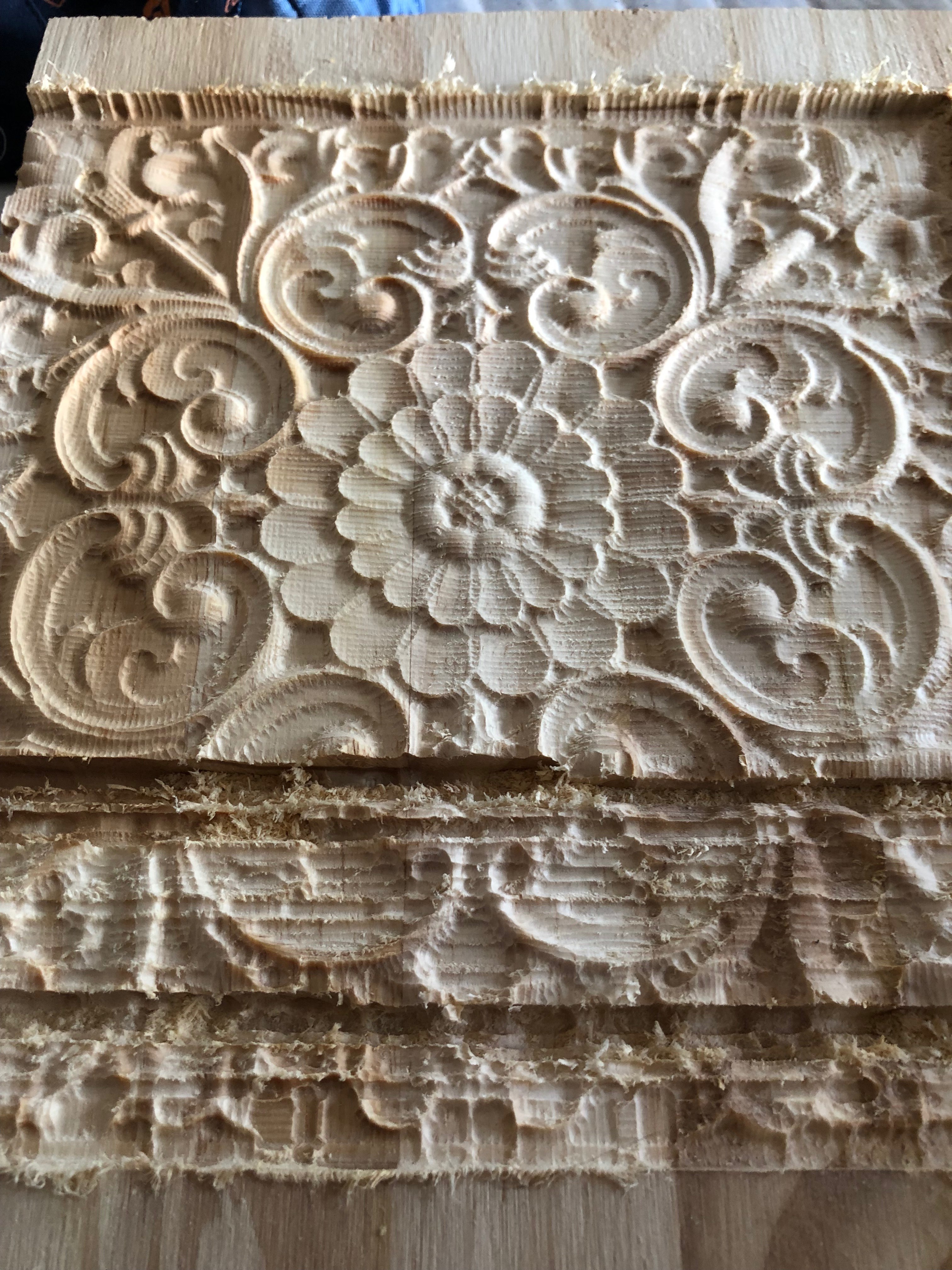

Here’s the completed cut following the mechanical mishap I had last week. I decided to go ahead and complete the cut in case I want to make the design in the future.
So what was the problem? Was your machine just binding up?
@Paul_Frederick The collet chuck got loose from the vibrations and the bit slid down the collet. I noticed it this morning. I’m always afraid of over tightening it and not being able to get it off.
Maybe I should spray the threads with an adhesive
@George_Allen if you don’t bottom your tools out in them and snap your collets into the nut before loading them they work good. Failing to do any of that is when you may have some problems.
@George_Allen the friction of the threads alone should do the job as long as you’re using the tools right. No one else is gluing their collets for them to hold.
@Paul_Frederick I should add that the shanks of your tools and the insides of the collets themselves should be clean and dry. Some oil in there may cause problems sometimes. So a good wipe with a clean rag doesn’t hurt. I’ve seen a lot of machine operators being fastidious with their chucks at times. You don’t want some grit throwing your runout off anyways. The threads can and should have oil on them. Oiled threads actually torque higher. You can cinch threads down further if they’re lubed. We are using the thread here to push the collet into the taper too. So more movement is better.
