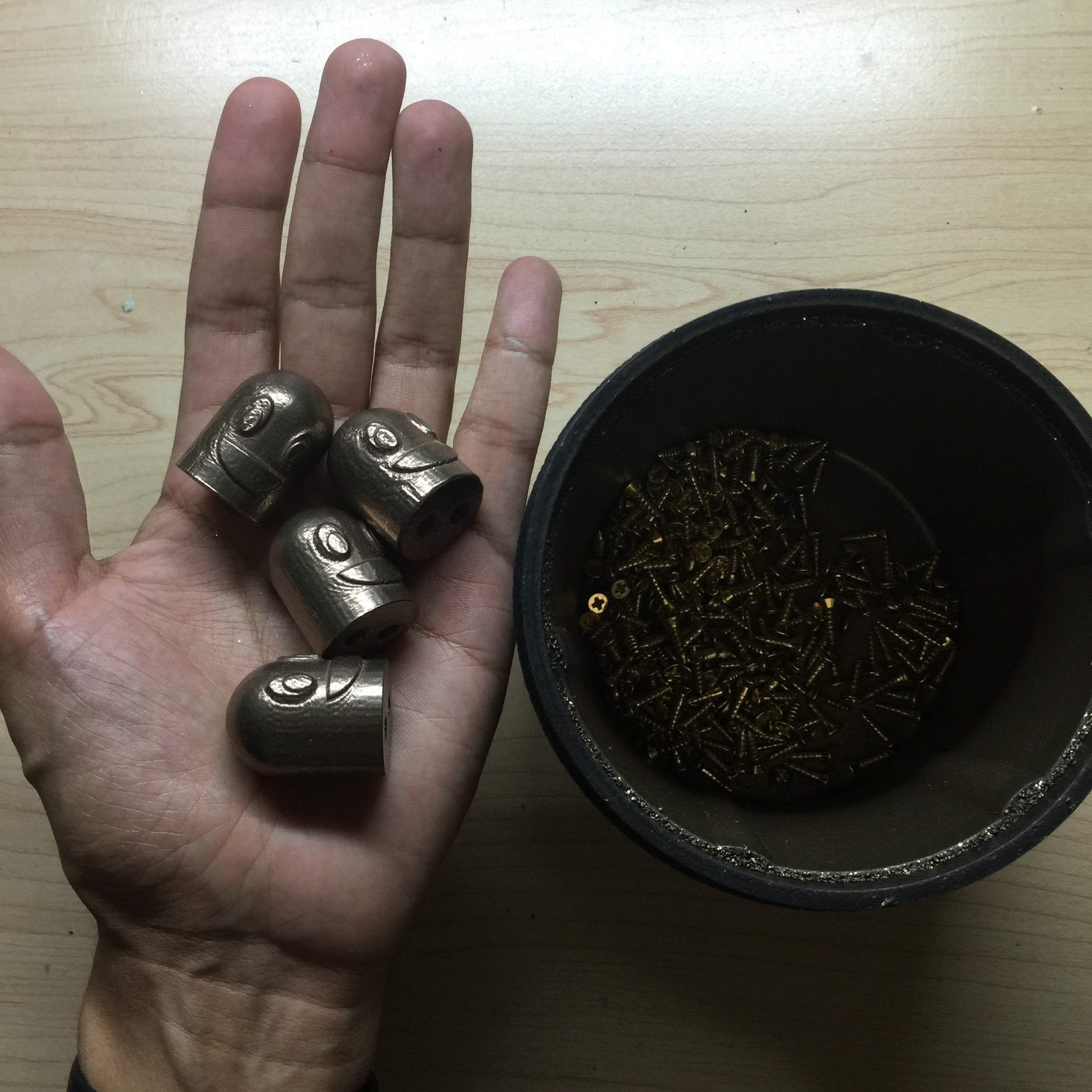

Here’s a before and after of tumbling parts printed with colorfabb’s copperFill. About 200 brass screws as the medium for 7-8 hours.
Nice, they look awesome.
Are you using a steel nozzle?
It’s interesting to see how the ringing artifacts in the print seem to become much more visible, certainly something to keep in mind.
i’ve tried in a tumbler but my result was not so great, ( must be super dry) i find it goes much faster and better with a dremel and felt and polishing pastes. for brassfill.
Okay, the before and after is amazing.
Is the model available? I have a sample of the material and have no idea what to do with it.
I’m not quite sure about the nozzle, though the coloring eludes to steel. The parts with the ringing artifacts were actually sliced with makerware and printed on a rep2, I’m assuming the acceleration and speed contributed to that. The last parts in brozefill were printed with the TA Series 1 and sliced with S3D. I’ll upload the models within the coming weeks to go along with the full set. Could try printing marvin in the mean time

Does the screw material affect the color? Like steel made it look like steel . So if you tumble with stones, what will happen to the final color?
