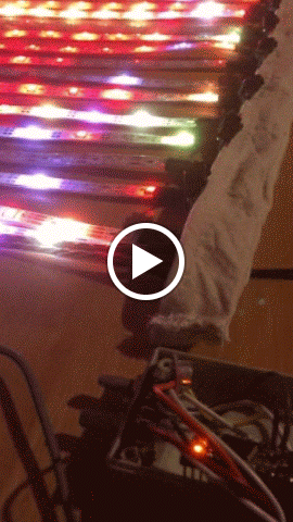

Here’s a clip of the sound-activated fire, with the teensy’s pin 13 LED indicating where it’s clipping my power output to 20W.
Beautiful! That’s exactly what it’s supposed to do, and exactly what it’s supposed to be used for!
Makes battery/power management so much simpler now… just dial-in the wattage or amperage you want to limit to, and bam, done. (Finally.)
