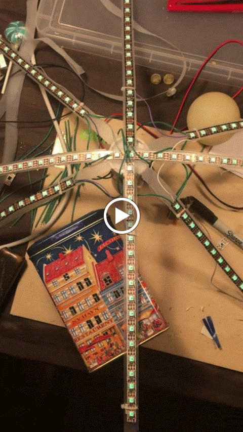

Here's a funny one.
Here’s a funny one. Any idea what might be causing this? Every few fades, the last 25 LEDs in the string glitch out.
Interrupts turned off, on an RFduino. Replaced the remainder of the string at the busted point (a couple of times!) and still get the same result. Code is on Pastebin (http://pastebin.com/6upfBLxr). FirstLight works fine.

I can’t see it clearly on the video but could it be that the glitch happens during color white ? -> power?
Not white, in particular—it’s picking a random hue each time and fading up a different colour. Not sure if it’s consistent. Will try all-White and eliminate power as an issue.

But even so: turning interrupts off with a full-white fade gives me a funny flicker on increasingly more of the LEDs on the down-fade as the thing warms up. Setting setBrightness(128) with interrupts off gives me a better result in the colour mode with some flicker on the way up, while setBrightness(128) with interrupts on gives me basically the same result I had originally, with the last 25 LEDs in the string going a different (usually dimmer) colour about a third of the time.
