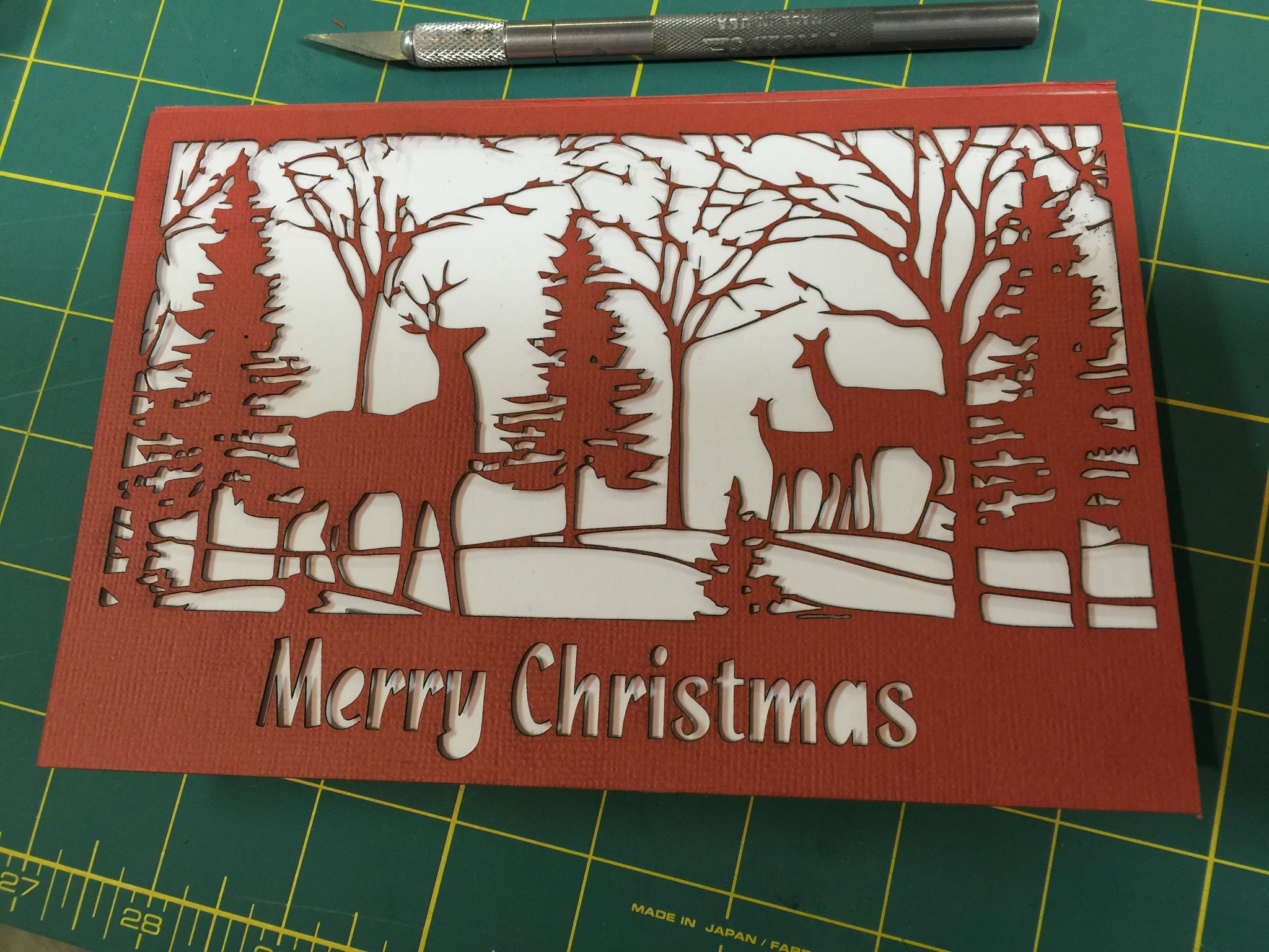

Here’s a holiday card I created with some red and white cardstock on a lightobject DSP upgraded eBay 40w k40. The image started from a card on Pinterest. From there I used Corel Draw 7 to turn it into a dxf and then import into LaserCAD. The cardstock is 90lb+. I cut using 15% power at 20mm/s.
Nice work
Happy tree’s
