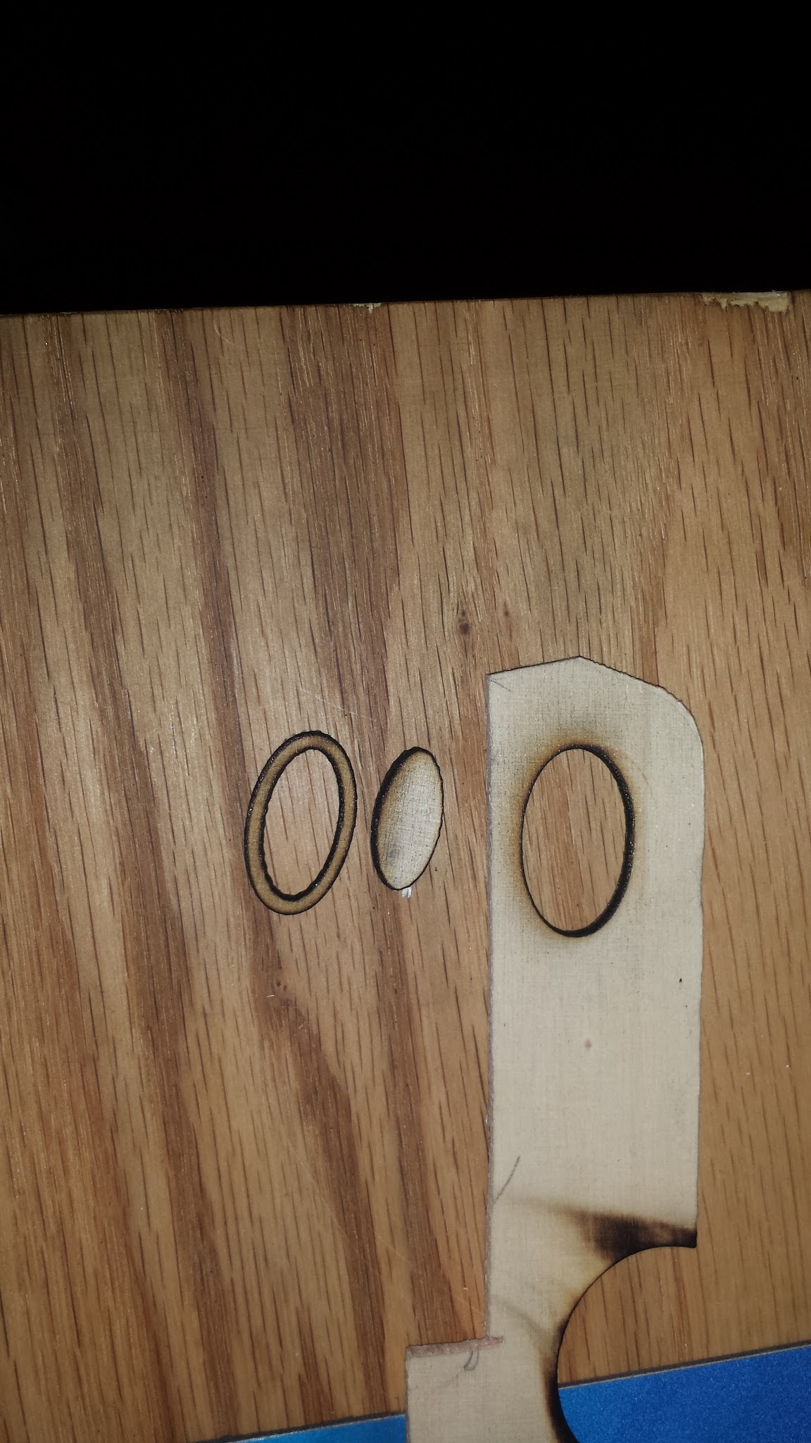

heres a picture of the ply i cut
As @Yuusuf_Sallahuddin_Y mentioned, you should be able to cut through 3mm ply.
How many passes, looks pretty black on the bottom? What sort of table you got in there?

What power settings are you using @Dennis_Fuente ? Seems to me really black on the edges as @I_Laser mentions. I’d suggest dropping your power (it creates a finer cutting point). Also, what kind of plywood is it? I am using a really cheap plywood. Can you do just a single dot fire (with the Test Fire button) using 4mA power. You can hold it down for say 1 second. I’d like to compare the result of that with what happens when I do a single dot @ 4mA. Maybe do a few different power settings & I will do a comparison test/photo up for you to check. (e.g. 4/6/8/10mA).

As asked, how many passes at what power did you achieve the above picture?
Hi guys so lets start off with the CNC mill it’s a 2002 Lagun 4 axis 5 1/2 HP 3 phase cat 40 pneumatic head mill so for making small wood parts not really the way to go it can certainly do the job but running cost are high, the above ply was cut at 18 MA and 1 pass, the ply is a 3 MM popular wood 3 layer cheap plywood hobby grade, i am in Calif USA the SF bay area, after finding the lens issue the machine seams to be doing better in cutting thanks guys for all your input and help
@Dennis_Fuente 18mA seems to be the reason the black charring is so much then. Have a go at much lower settings (now you’ve got your lens issue sorted) & try something like 10mA @ 25mm/s @ 2-3 passes. See how that goes for you. Hopefully with the lens issue sorted you can get better results.
