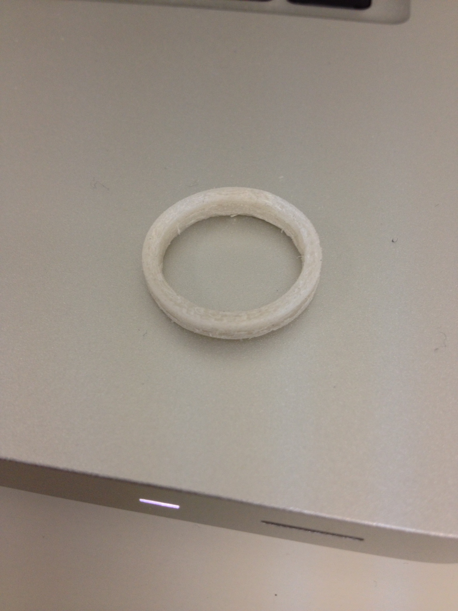

Here's a ring 3d printed with a wax filament! Low temperature is needed.
Here’s a ring 3d printed with a wax filament! Low temperature is needed. I’ll try to cast an object with the lost wax process; it seems to be the best material to do that.
Where do you get wax-filament? Does it cool quickly enough?
PLA should work well for that too. others have even tried ABSm, but I would advise against that because of the fumes created:
Of cause wax is much easier to postprocess to get the surface smoothness/texture you want to have.
…at least as long as 3d pritners haven’t reached layer heights of 1/100mm(visible surface texture) or 1/1000mm(“touchable” surface texture) but only 0.1=1/10mm or 0.2=2/10mm.
I spoke to my dad a while ago about this…he is a goldsmith and do lost forms in wax. He has 2 different waxes and they melt at different temperature. I think it is doable, but the wax is so soft you easily squeeze it between your fingers. The pressure on the filament must be minimal. I think the extruder-gear must be replaced to a wheel or similar.
important is to test if PLA leaves behind anything when it gets heated to empty the form, I do know wax doesn’t
Hi everybody. Someone else try the lost wax process with PLA before but the results weren’t the best, so we think there’s the opportunity of new challenge with wax filament. The filaments I used comes from my lab, Design for Craft (www. http://designforcraft.com), they are experimental. Of course the resolution is a weak point but we can work on the final finish of the piece (smooth)
