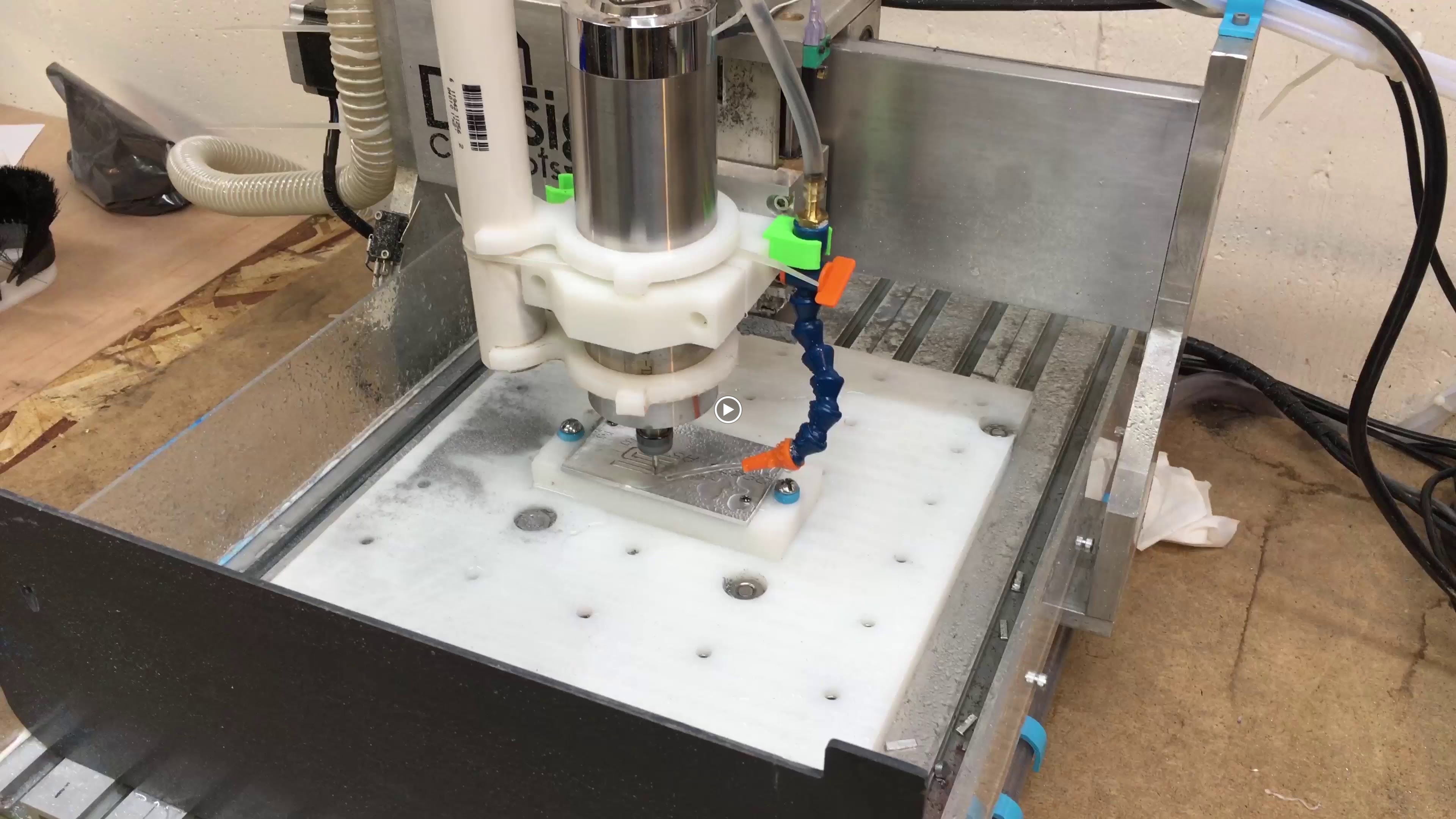

Here's a short video of the coolant add on I made last month.
Here’s a short video of the coolant add on I made last month. Made all the difference in the world.

Awesome manufacturing bud! the whole machine looks great!
What bed material are you using?
Thanks @Brandon_Satterfield
It’s HDPE, McMaster p/n 8619K482
Now if only I could get small jobs lol
OOOps sorry bud meant the extruded Al. There used to be wide pieces at musimi and 8020 but cant seem to find them anymore.
Only water at this time. Just have to thoroughly dry off the end mills when I’m done. I have no idea what kind of coolant I need :confused: @brian_alley
