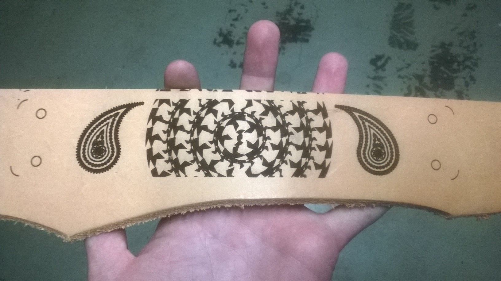

Here’s a test I just did on 3mm leather. Settings were 6mA on the dial, 500mm/s engrave speed, 1 pixel steps.
Obviously it doesn’t engrave that quickly though. Took more than 10 minutes to complete the project. Didn’t time exactly.
Very neat. I had some results markibg on the inside of some soft 1mm scraps and is cut quite cleanly in the outside of the same but I didn’t take the speed/power settings.
I’d like to be able to cut small patterns to stitch together for 3d keyrings or wallets etc.

It’s a good work.
