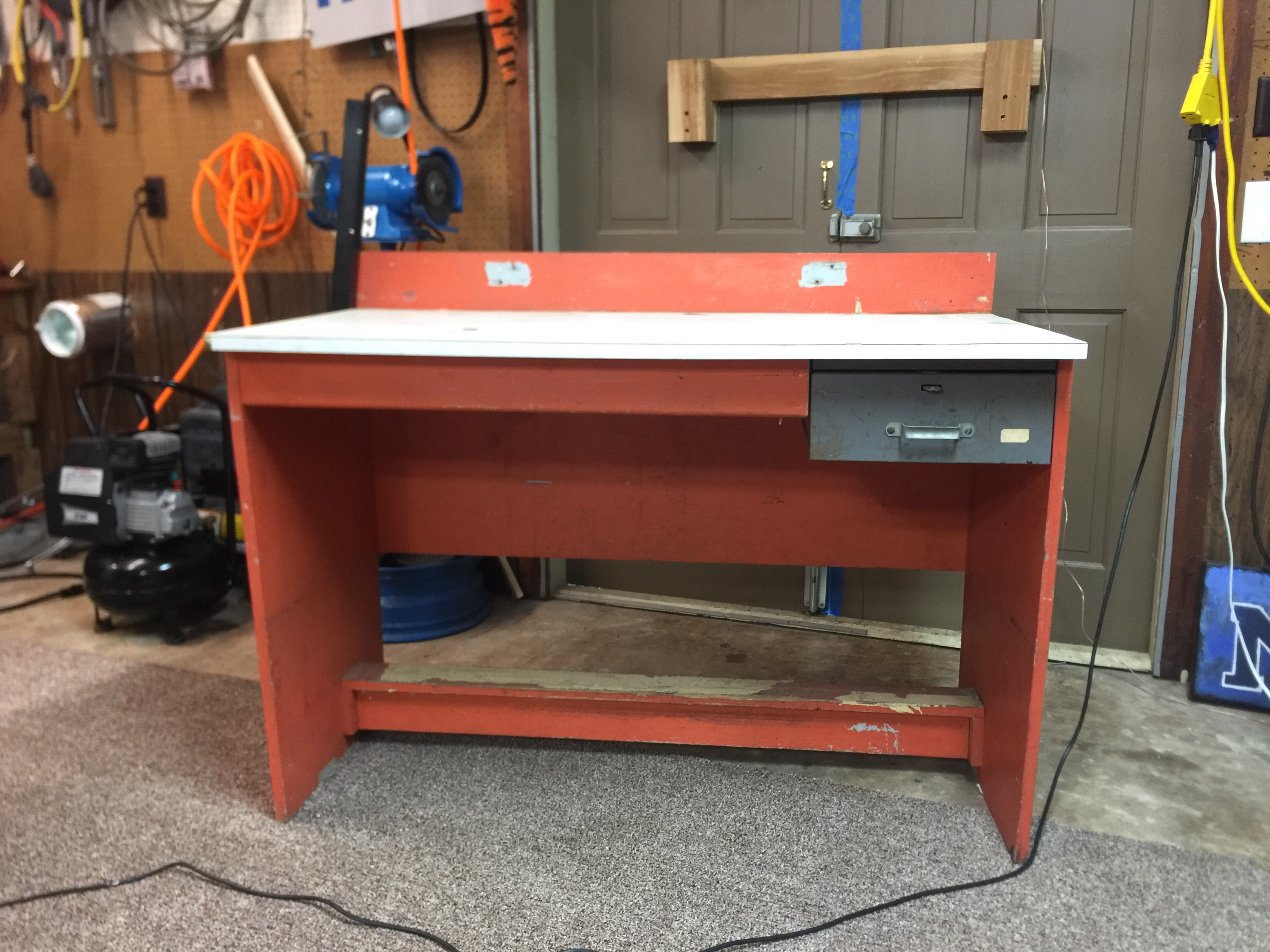

Old work bench will mod with casters and some of those adjustable screw feet to level in place.

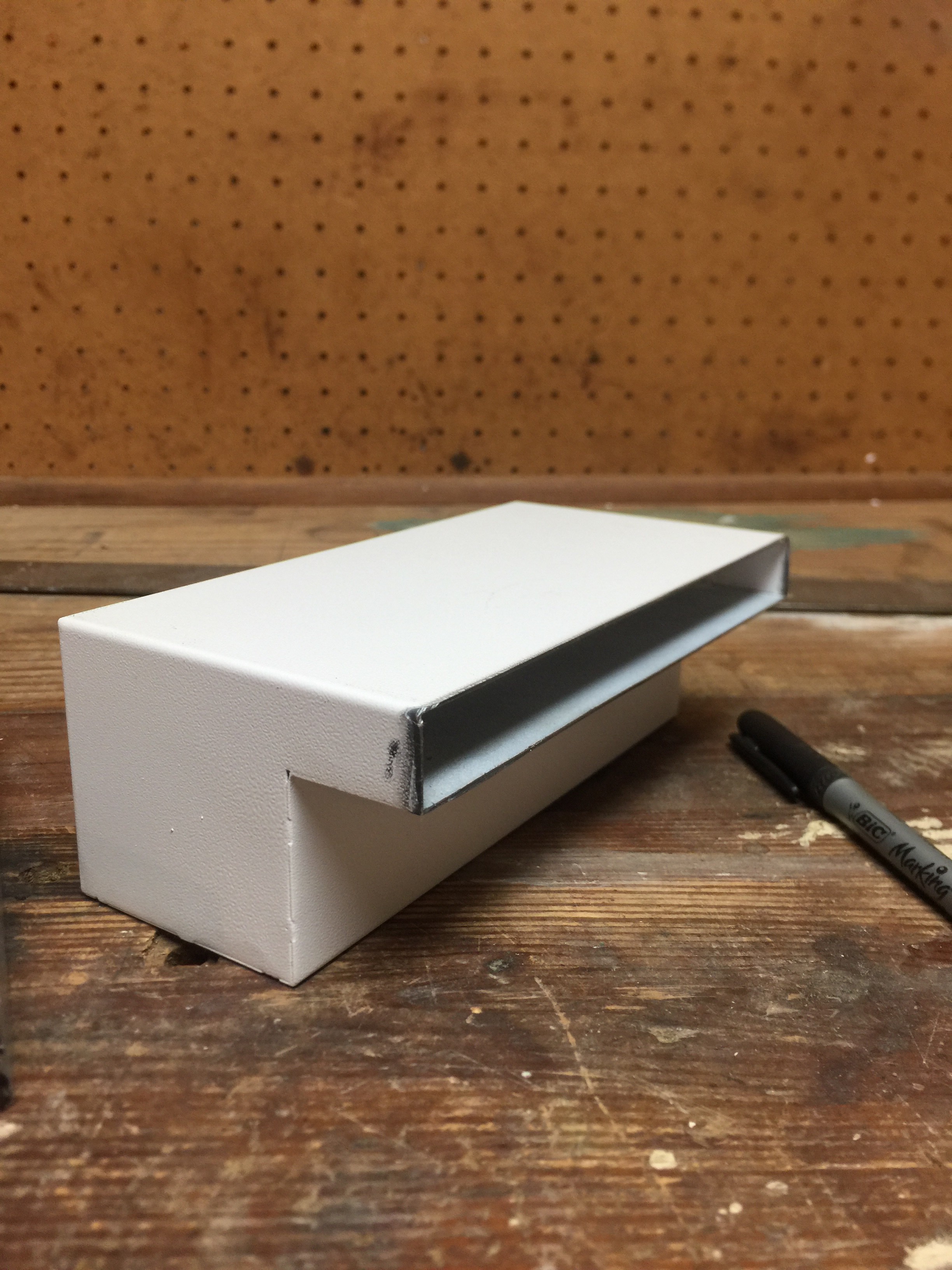

Exhaust duct shortened de-burred edges won’t cut you!
@William_Kearns I removed mine altogether and just cut a 110mm Dia hole around the original oblong slot to suit the stub for the extractor in the back. (I had to blank off in some of the oblong tho)
Fitted a bigger extractor and does the job really well now. much happier with extraction.

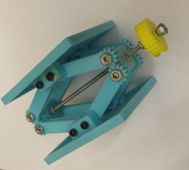

I used a scissor jack before I upgraded to a Z axis, I 3D printed mine, worked great!

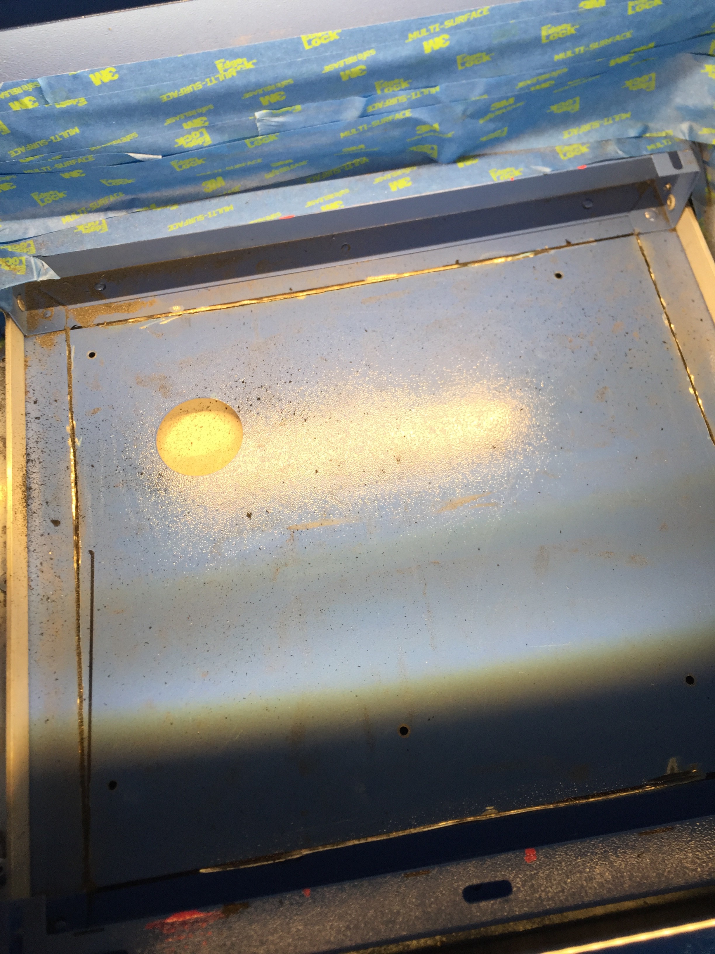

Cutting bottom out for z table (lightobject)going to double its travel distance
