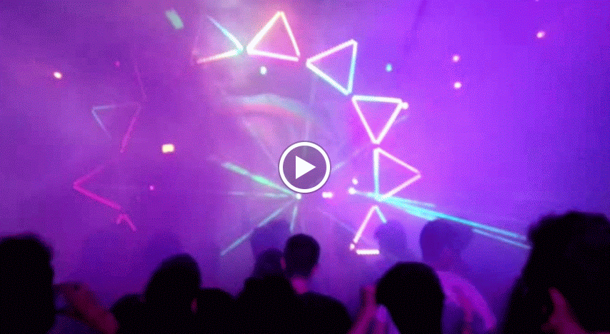

Here's my first big led project for my decoration association.
Here’s my first big led project for my decoration association. Thanks to all of you for your work and inspiration :slight_smile:
WOW! Looks GREAT!
What microcontroller are you using there? And is it sync’d to sound, or just innately awesome?
Thanks :slight_smile:
I’m using a Teensy 3.1. Not yet sync’d to sound. I really would like to make it react to music but there is a lot of work to do it!

I’m only Amsterdam so I could come and see :-). Is it permanently installed in a club, or just set up for one gig? From a rough count I reckon on about 500-600 LEDs?

@Robert_Atkins Oh yes not too far :slight_smile: It’s not permanent, but I think we will show it at every next parties we will decorate. You can follow us on facebook (https://www.facebook.com/CosmoVisionDeco)
The project was to have 576 leds but here are 2 triangles missing so only 480
This is awesome! This is all just one Teensy? Does each triangle have its own data line?
@Ryan_Clough Thanks :slight_smile: Yes there is one teensy to manage all the structure but I didn’t want to solder on it’s back so I used the OctoWS2811 shield. There are 2 triangles per data line and I can’t wait to have parallel output in FastLED to get it faster :slight_smile:
