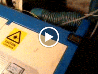

Here's my issue. Used it for around 6 months, absolutely fine.
Here’s my issue. Used it for around 6 months, absolutely fine. Woke up this morning, pressed the test button…
Going to take a look under the silicone seal, it may have work out and just need re-wiring, do you think think is the issue?
Hope so, getting it check out by an expect on Wednesday. Thanks again to everyone for their support :wink:

That looks very similar to what mine was doing, for me it turned out that the rubber tube insulation that should be covering the connection was missing (the wiring was fine), i just siliconed some rubber tubing in place and all was well.
