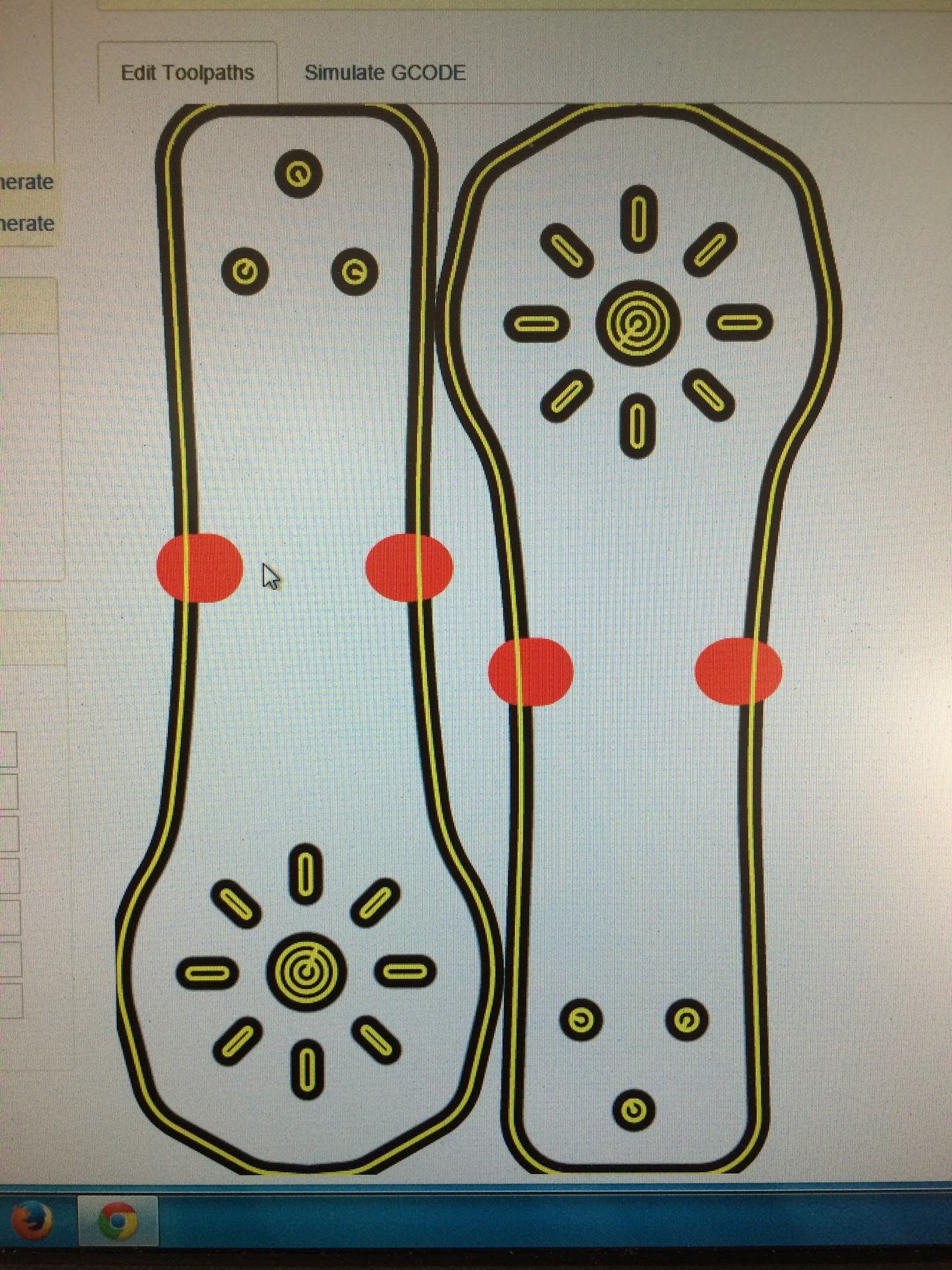

Heres some pics
Ahh, so my gut tells me that your tabs are milling, but you are inaccurate as to the Z zero of the top of your workpiece. You are showing 6 passes to cut all the way through. Your tabs only are as think as one pass. I bet you are cutting all the way through on the 5th pass, so that 6th pass is pointless and is cutting into your wasteboard. It’s leaving a tab in your wasteboard, but it’s a pointless tab. Just a guess though.
I’ll try it with taller tabs, I was thinking the same thing but I watched the bit on the 6th pass and it doesn’t move up and back down right there but maybe I missed it.
