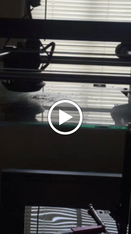

Here’s the binding at slow speed
The movements appear to not be impeded by the binding you describe. It looks pretty smooth at the slow speed?
You can’t hear the noise?
That doesn’t sound like binding. It sounds more like resonance. Are you belts too tight?
That seems not to be a binding noise. More like resonance. Belts to tight or to loose? Wheels not aligned so belt is rubbing against sides?
I can’t see any rubbing and it only occurs at two areas that’s what makes me believe it’s binding

I’ll try taking some tension off the belts tonight but I’m not sure if that’s the issue. How smooth should it move without the motors attached? To me it feels smooth but I’m not sure if that’s enough

@Derek_Schuetz when you push by hand into the corners do you feel any sticking when you push back out. A good test is to turn the stepper pullies by hand very slowly (you will have to take off the belt guards, and go slow so you find drive current back into the board). It should be easy and even, both in to and out of the corners.
