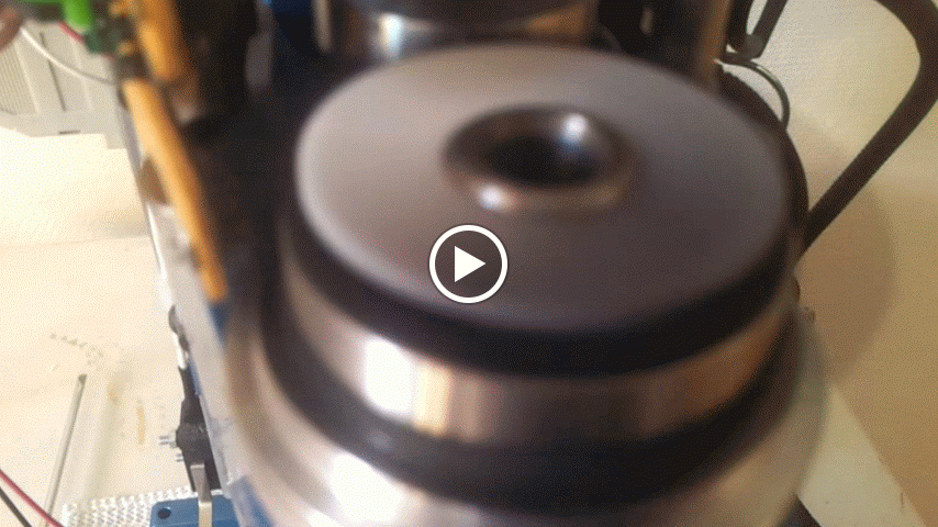

Here’s also some picture material from the process. I’m experimenting a lot to find the right solution.
The detector is NOT from a mouse. Initially I just found the part between parts from mouse’s I have scavenged but it’s clear now that this part is not coming from a mouse. Sorry about the confusion.
That looks nice. The opaque half circle doesn’t add vibration? Or is it so light it doesn’t matter.
You’re right, it’s very light…
