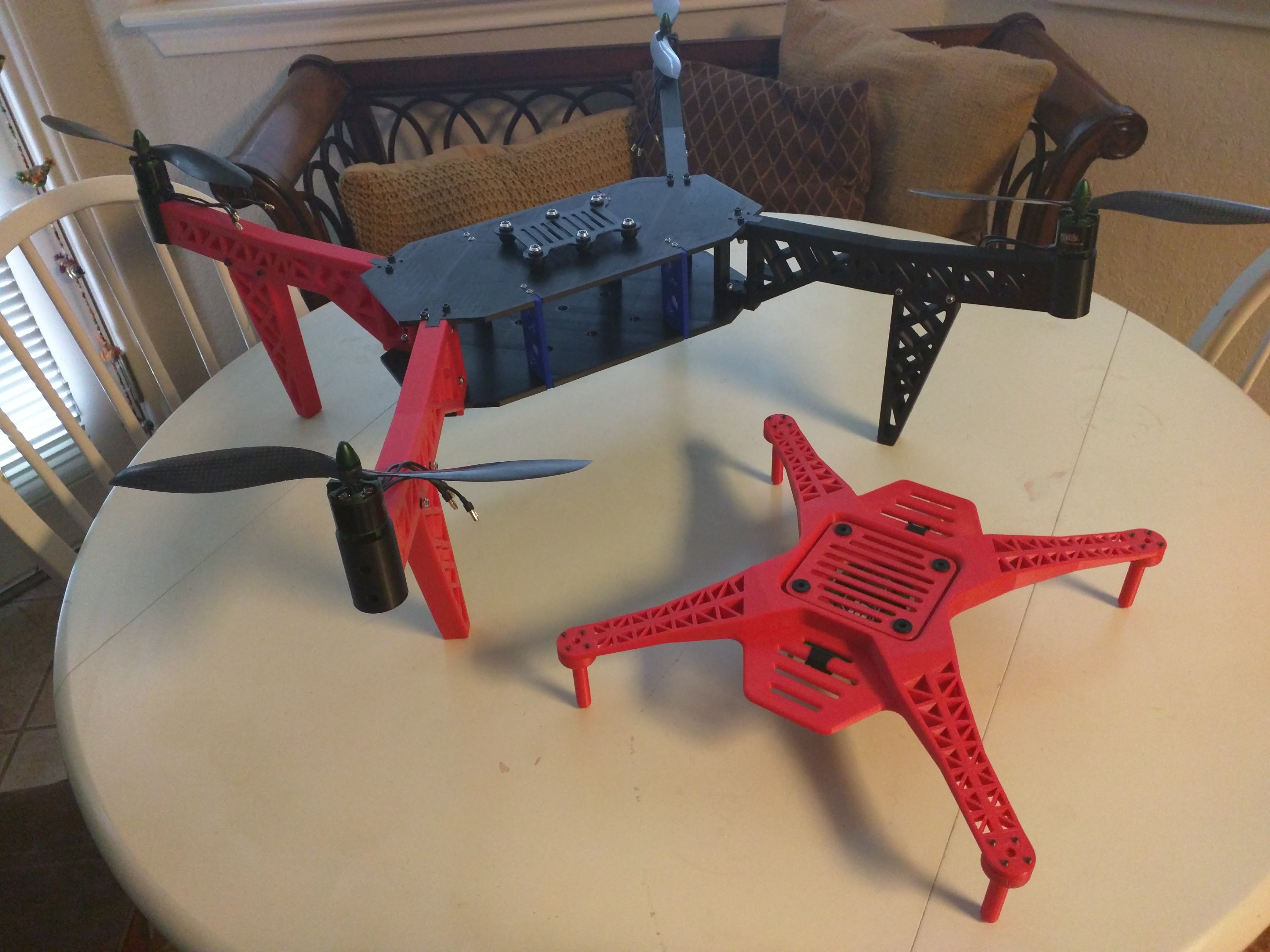

Here’s what my herculien has been up to these past few weeks.

Did you model these? They look great.
Yes I made every piece in solidworks
The big one is 800mm motor to motor diagonally. It is going to carry a couple gopros and lots of batteries to do aerial photos. The smaller one is just a project I started one night when I was feeling inspired.
The small one looks like the main section is one peice. Good use of the big build area.

What material are you printing with?
How well does 3d printed drone parts do compared to things you can buy?
I suppose it probably requires more mass for the same strength/stiffness?

@Daniel_Salinas for a guy who didn’t know solidworks before you are doing great. Holy cow. Sorry we never got that hangout going to show you some tricks… But it looks like you don’t need my help
@Carl_Hicks yep it started as a 310x310mm square.
@Oystein_Krog I print almost exclusively in ABS. I’ve found that you definitely have to go for thickness with strategic cutouts to keep rigidity high and weight low.
@Mutley3D I don’t print props yet. But I haven’t given up on the idea.

@Daniel_Salinas you willing to share the model and component selection? I really want to get into this, but I am not up to speed on what to buy.
Totally. Once I get the last components in and I test. Then I’ll put everything on youmagine. In the interim I’m happy to chat about it.

@Joe_Spanier it will likely need bigger motors and 15 inch props. It should have plenty of lift with the current props but once I load it down with a bunch of battery packs and a camera / gimbal it will likely need more power.
