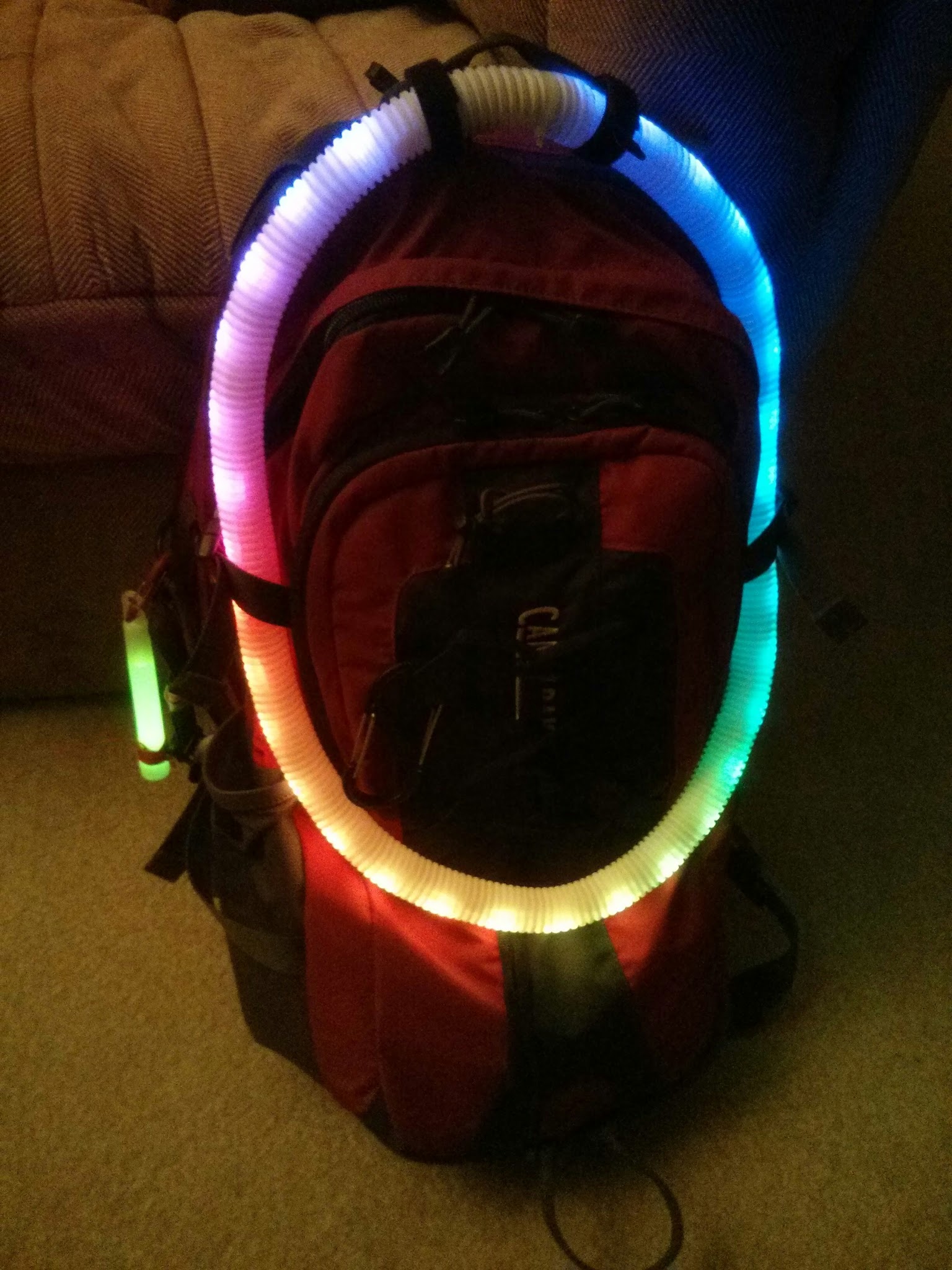

Here's what the finished setup looked like for some LED fun I put together
Here’s what the finished setup looked like for some LED fun I put together for a 3.5 hour night “glow” hike. It turned out great. The 28 hikers all had multiple glow sticks in all varieties, but this was a total hit.
LPD8806 strip (1m long, 32 pixels), controller was a Teensy 3.0, and power from a cell phone recharger battery. The strip was slipped into one of those 1" cable organizer tubes and that attached to the backpack with a few Velcro straps. Controller and battery tucked perfectly into a little pocket on top of backpack. I had the master brightness turned down to 40 but it was still really bright out on the dark trails!
Code was a modified DemoReel100 sketch and a few more added patterns that it randomly picked between. I made a few patterns “rare” so they didn’t come up all the time, and one of the calmer patterns sort of the default that ran about 60% of the time.
Ooh!, I was looking for something like this to build. Where did you get the wire loom? It diffuses the light really well!
Nice! I picked up some wire loom from Ikea, been meaning to try it out. Thanks for the nudge. :slight_smile:
@Adam_Wright ​ Found it at Home Depot in electrical area. It works very nicely.
@marmil Thanks! I would have guessed there, but wanted to make sure before I made the trip. Prices on Amazon were outrageous
It also looks a LOT like pool tubing (which I have used in addition to split loom).
I guess the advantage of using pool tubing would be that it’s more sealed/protective against the elements since it’s not slit open. @Andrew_Tuline , were you able to buy the pool tubing by the foot or in smallish lengths?
I bought it in one long tube (whatever was available at Canadian Tire) and then cut it to 1M lengths over time.
