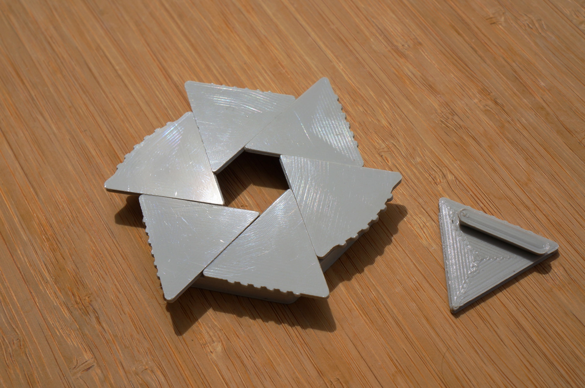

Hex-Box d218|17 made this simple segmented cover/lid with box (7 parts).
Hex-Box d218|17
made this simple segmented cover/lid with box (7 parts). The ability to have a changing orifice gives a lot of applications. As the lid is always connected to the box there is nothing to loose,hold or lay aside . I am thinking of adding a thread instead of the box so it could be used on a honey jar where you can leave the “spoon” in.
The segments have a little groove on the side so there is no gap between the elements.
When closed the dovetail openings on the side also get locked - so they are sealed too.

So, on topic… it would appear you don’t have grooves and tracks for the pieces, that would really improve the performance I’d think.
@Rob_Nance can you please elaborate this a bit further? The segments have interlocking grooves so there is no gap between segments and the segments are guided with dovetails for the translation.
here without the segments:
That’s fine, I’m talking about the edges of the lid, it doesn’t appear there is a groove on the left or ride side for them to slide with each other. If you put a tongue on the right side, and a groove on the left, the action would hopefully clean up some.
EDIT: I just re-read your original post and it sounds like they are there, but the video shows them clearly struggling to stay together, so perhaps some tweaking is needed there?
as the segments are only 2mm there is not much space for guides. With thicker segments you can have them deeper. The box in the video uses an alpha design where the dovetails are not long enough to ensure stability when open. Also it could look like that there is a gap due to the shadow as the segments are very tight and have a slight pressure — but i can ensure you there is no gap.
You can see the groove here. If i lower the angle of the groove to make it deeper, you get overhangs that can’t be printed without support - So the only way would be to make the segments thicker.
