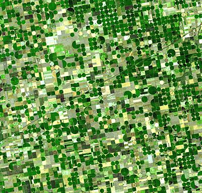

Where do you have circular fields?
Never been out in the fields? Never looked out of the window of an airplane?
Fields over here don’t look like that.
That explains why you didn’t think of wheels. ;-), They have been invented in other parts of the world. :wink: No serious. It’s a tested and widely applied system in many parts of the world. The circular form and overhead solution has a lot of advantages. Like one central point for delivery of water and other inputs. Wheels are not a problem, the system has proven to work. You could mount more nozzles in one lane, to speed up delivery when needed.

Sound like an inefficient us of the limited farm land. Could make sense where the ground won’t be fertile at all without artificial watering and is less of a limited resource.
Your observation is correct. And when land is the ultimate limiting factor, maybe even right. But there are other factors that enter the equation of profitability of farm operations. We do produce mostly round bottles, while square bottles do exist, don’t we? To comfort you, the same overhead system exists in a linear form, so farmers have the choice.
We are talking of typical field sizes of 50 hectares that are served with only one ‘single’ 400m pipe and nozzles.
That is a rectangular field of 5000x100m. If you want to lay tracks and you have rows 1m apart, you need 505,000 m of tracks, right? If you lay them 10 meters apart you come down to 50,500 meters. If you lay them 100m apart … See where wheels that can transport the track can make a difference? When you are still gathering ideas, i think it is an alternative worth looking at and not to be discarded to soon.
