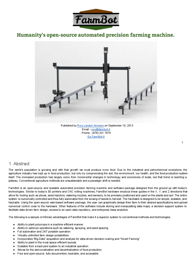

Hey 3D printer makers! Ever thought about applying 3D printing concepts to farming? Well,
Hey 3D printer makers! Ever thought about applying 3D printing concepts to farming? Well, I’ve been working on a project called +FarmBot , which is an open-source automated precision farming machine. Think of it like a giant 3D printer that has a seed injector and watering nozzle instead of a plastic extruder! I just published a white paper about the technology and vision and would love some feedback and some sharing love. Thanks! #FarmBot

Why is it placed on tracks and not wheels? Sensoring can guide the farmbot. Another question what is special about this bot, above the already existing bots?
Tracks as more reliable (mud, fallen leaves ,ditches) and don’t compact the earth?
blueray lasers can provide adequate heat at a critical point of the weed (it will wilt in a few days) no need for chemicals i guess. laser can charge via solar.
@Bert_Sonnenschein , the choice of tracks is to specifically avoid the “free-driving wheeled tractor” approach that is common today. Sensors could guide the bot, but it would be less accurate and much more expensive. In addition, as @Marcus_Wolschon pointed out, tracks are more reliable and the machinery does not compact the soil by driving over it. Furthermore, using narrow tracks allows for less “machine pathways” to exist which means more area for planting.

Wheels might work better on uneven terrain / sloping terrain. This will need some kind of adaptation to work on terraced agriculture.
But rails will never be uneven terrain :wink:
(Any they work better on terraces then weels ever could)
@Marcus_Wolschon exactly!
@Rory_Aronson Ok there are some pros for tracks, but tracks out in the fields need regular cleaning, so you need an auto-cleaning device on it.
But still 100ha or a 1000ha of crops would need kilometres of tracks. How would that work out investment and maintenance wise?
Maybe you can have the best of both worlds? One direction tracks, mounted on caterpillar wheels that reduce soil compacting. Yes, a set of wheels need a motorand a motor needs maintenance. But I just cannot imagine hundreds of hectares planted with tracks. Maybe mounting it on a drone? :wink:
Thinking of drones: hanging the tracks from above and sliding these tracks along other perpindicular tracks. Like the do in large factories. This reduces mud on tracks also.
