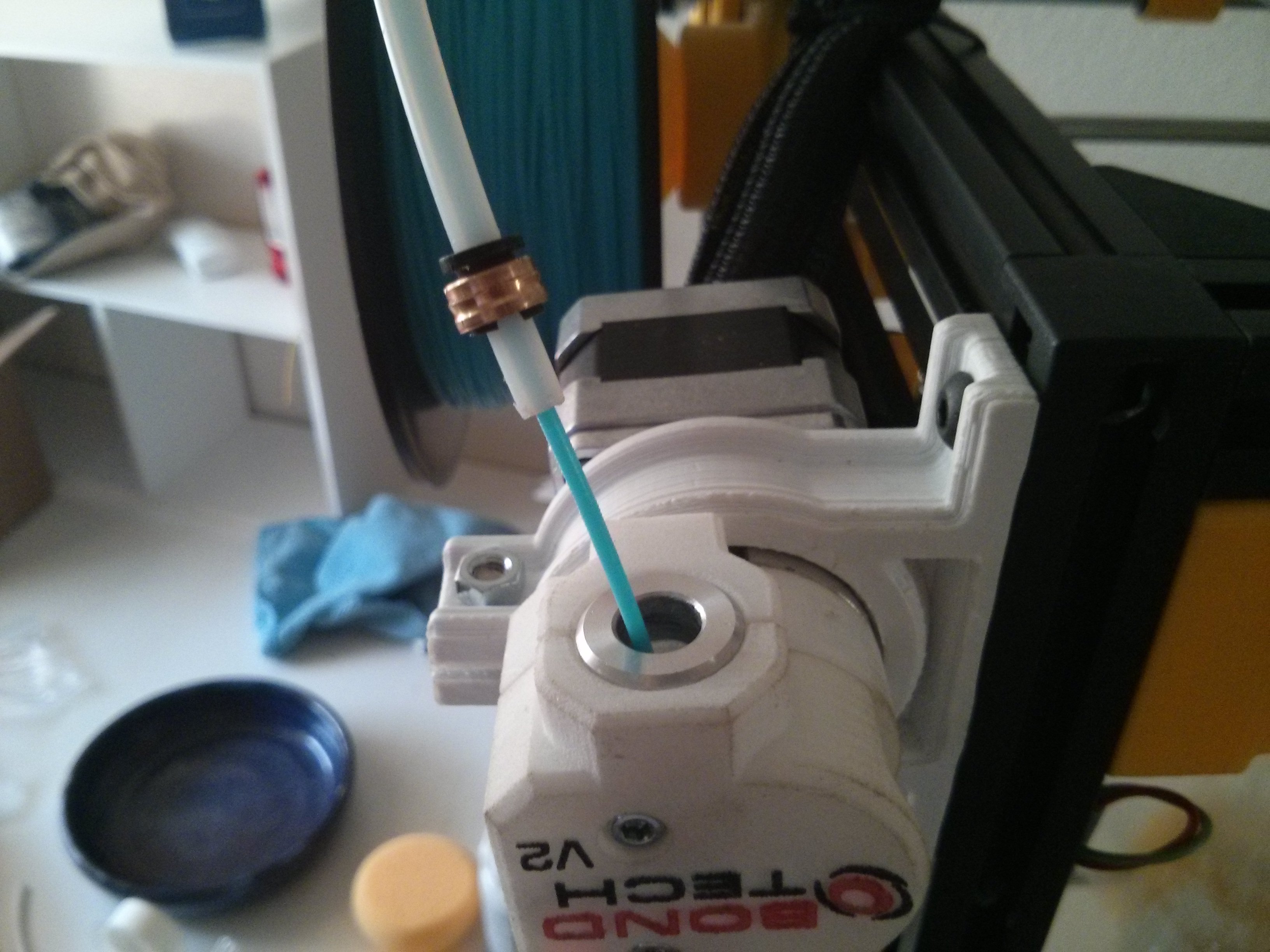

Another weekend, another day of tweaking. Managed to get print quality much better than last time, then my bowden tube started popping out of my Bondtech extruder.
Anyone experience this? It seems I can’t complete a print now without this happening. Its happened 3 or 4 times now. This started after I switched to some cheap filament that definitely had a clogging issue, the nozzle clogged and then the bowden adapter popped out of its housing.
Since then it has happened 3 or 4 times with this blue filament which I’ve been using from the start and is generally good (protoparadigm).
I had wondered if the bowden path was pad, I know tight turns are to be avoided. I’ve included a couple of shots of the hot end at its various positions, near, middle and far. This popped out this time while printing around the center of the bed.
Is there a better way of hooking up the bowden? I’ve been considering adding some extra extrusion to mount the extruder above the printer and just have the bowden coming downwards to the hot end. Anyone tried that?

I think Martin presses that fitting in. To get you through for now I would recommend a little JB weld on that brass piece, then push it back into the housing and let it cure. Then it shouldn’t pop out again. The plastic shark bite portion can/should be removed from the brass piece while you glue it in.

OK so gluing it in is ok? I’ll give that a go, I think I have some epoxy around.

@Martin_Bondeus and I were talking about this a couple weeks ago. He said he’s started taking a punch and putting 4 points in the aluminum around the brass to give it some more tension. I haven’t done it to mine yet there last time I pressed it in its started.
@Joe_Spanier that sounds interesting. How would you specifically do this? On mine the brass goes about 1mm down inside the aluminum. Would you punch the top edge of the alu down into the hole to seal in the brass?

Also put a length of tube on the inlet of the bondtech extruder. It helps guide filament more smoothly into the extruder. BTW, why is the bondtech extruder mounted upside down? On mine I use the other side as the outlet for Bowden.
Yeah, when my new tube arrives I’ll add that. I’m confused, how did you manage to have the other side be the outlet? Surely the groove mount part is where the exit is designed to be?
@Ben_Delarre the design can run in either direction. I have the bottom as the inlet and the top as the outlet when the text reads right side up. Both side have bowden tube fittings. All you do is reverse the motor direction.
